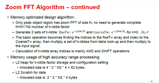

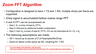

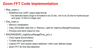

I just found 3 page docs (and source code offcourse ) about how TI implement Zoom FFT for High Accuracy f/w.
Is there some kind of doxigen docs ? I only find user guide html on industrial_toolbox/level_sensing folder.
It will be helpful
