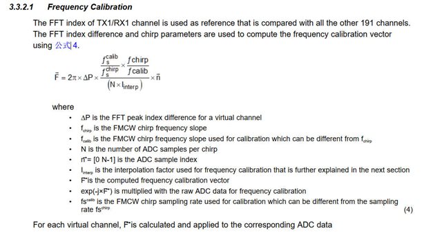

Dear TI,
In the AWR2243 cascade board (DSP+RF), the frequency, phase and amplitude of the data need to be calibrated before MIMO imaging.
And Frequency calibration formula is given in TI document, as shown in Figure (a)
Figure(a)
Can you provide the derivation process or frequency calibration principle of the formula for our understanding.
