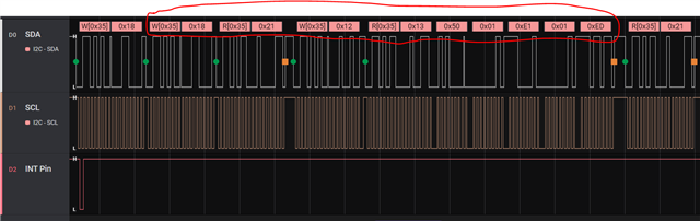

    Yesterday I received a TMAG5273EVM, that I hooked to my nucleo l432kc and ran my test FW. With both the A1 and A2 version, I could have the issue occur when leaving a magnet continuously close to the sensor. It took ~15 minutes to have the A1 "not responsive" and ~20 minutes with the A2.
    In order to see the state of the SCL/SDA/INT lines when the sensor appears to be not responsive, I toggle a GPIO if no interrupts were detected in the last 20ms and use that to trigger a capture. In all the following figures, the labels of the line are:
    • GPIO: Set to 1 by the MCU as long as interrupts are received. Set to 0 if no interrupts received since 20ms
    • INT: interrupt line controlled by the TMAG5273
    • SDA: SDA line
    • SCL: SCL line
    Expected behavior
    First, I made a few captures to illustrate the expected behavior while a magnet is close to the sensor. Figure 1 shows one sequence of :
    • Interrupt firing
    • MCU reads  conv status & X/Y/Z data
    • MCU reconfigures the W&S mode

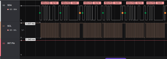

    Figure 2 shows the I2C transfer to read the conv status & X/Y/Z data.
    Figure 3 shows the transfer to reconfigure the W&S mode.
    When a magnet is left close to the sensor, the expected behavior is then according to Figure 4, where the sequence from Figure 1 is repeated over and over again.
     Fig. 1: Sequence of interrupt, read/reconfigure
     Fig. 2: Read conv status & X/Y/Z data
    Fig. 3: W&S reconfigure
    Fig. 4: Repeated interrupt sequence while magnet close to the sensor
    According to section 7.3.3 "Latched interrupt through INT" of the datasheet:
    "The interrupt latch is cleared only after the device receives a valid address through the SDA line"
    I would have expected that the interrupt line go back high during the read of the CONV_STATUS register once the TMAG5273 address is read.
    But as can be seen from figure 2, the line goes back low after this transfer, only to go back high when reading the magnetic data and then low again, until the W&S is reconfigured. Is this an expected behavior?

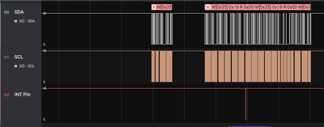

    One transaction consisting of INT trigger/reconfiguration is shown in Figure 9, which is part of the overall logic shown in Figure 10 while a magnet is left close to the sensor.
     Fig. 9: Only reconfiguring W&S once an interrupt triggers
    Fig. 10: Continuous interrupt while magnet is close to the sensor

  • Hello Alicia,
    Thanks for the precision regarding the non-responsive behavior.
    The test that I was running ended with the tmag being non-responsive after ~23 hours of continuous interrupt with W&S with SLEEPTIME=5ms.
    Figure 11 shows the last few transfers and Figure 12 the last one. One difference between the transfer in Figure 12 and all the other from Figure 11 is the duration of the interrupt line being held low:
    • Transfers from Figure 11: ~108-111 usec
    • Transfer from Figure 12: ~151 usec
    Maybe that is just a coincidence, or something like the time between the Interrupt line going low and when the interrupt is serviced is critical? Or the duration of the overall "interrupt line held low" time is critical (in which case the issue would be harder to observe if using I2C@400kHz instead of I2C@100kHz)?
    Fig. 11: Non responsive behavior with only reconfiguration
    Fig. 12: Last I2C transfer before non-responsive behavior
    The configuration used was with only the Z axis enabled.

  • Hello Alicia,
    Thanks for the suggestion. I have a test setup that is running with those changes (without reading the results registers).
    The interrupt line is going back low in between the setting of stand-by mode and W&S mode (cf figure 14). Other than that, it is running fine so far, but it only has been ~1h of continuous interrupt.
    I will report back after longer hours of testing or if I can trigger on the non-responsive behavior.
    Fig. 14: Set stand-by mode before reconfiguring W&S

    For the interrupt portion, when a threshold cross is detected, I have an interrupt service routine (ISR) set by the MCU to interrupt on a falling edge for when the INT pin on the TMAG5273 goes low. In this ISR, I just clear the interrupt and read the CONV_STATUS and result registers. The ISR tends to get triggered sometime between Step 6 and Step 7 which, based on my setup, seemed necessary for it to trigger.
    I have attached a waveform for what the I2C communication and INT pin looks like from when the device gets woken up to when it goes back to sleep below:
    Figure 1: TMAG5273 wakes up
    Figure 2: Wait for data conversion to be complete
    Figure 3: ISR gets triggered (threshold cross is detected)
    Figure 4: TMAG5273 gets put back into Sleep mode
    Figure 5: Overall I2C communication
