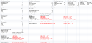

When I tracked the vehicle with iwr1642, I found that one vehicle became two vehicles side by side during the movement, and their distance and speed to the radar installation location were consistent. Which parameters are set incorrectly to cause this?What are the parameters related to this situation?
My radar tracking algorithm parameter settings are shown in the figure below
In addition to increasing the signal-to-noise ratio, what parameters can be modified to avoid this?

  • Hello.
    I would look to modify some of the tracking parameters.  It is possible you may have set the gating parameters small enough such that it allocates one vehicle track for an object that might be smaller than one.  You can refer to the other tracking commands in this document here.

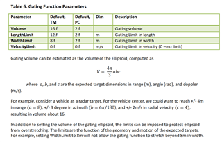

  • Hi,Santosh.
    My gating parameter settings refer to the default settings below
    [1]The default is the sequential configuration of 16, 12, 8 and 0. This configuration is rarely distinguished into two targets when a single lane vehicle travels. However, when vehicles in multiple lanes move together, it is difficult to distinguish vehicles in adjacent lanes. Where half of the LengthLimit value represents the expected maximum vehicle length? For example, the default value is 12, indicating that the maximum vehicle length is 6 meters. Similarly, WidthLimit is 8, indicating that the maximum vehicle width is 4 meters?
    [2]If I want to give priority to ensuring the detection effect of adjacent lanes. So how can I avoid a single lane vehicle being detected as two targets? What other parameters can I modify?

  • Hello.
    This should not be the case.  In the image you provided it says that the ellipsoid will not stretch past 8m if the width limit is set to 8, indicating that the widthLimit value is the width of the object, but the width of the track will stretch 4m from the center of the vehicle.  If you look at the tracker layer guide in the 3D People Counting Lab in the toolbox, you can find more information on what the individual parameters for each configuration command represent.  You can modify these individual parameters based on the performance you are seeing.
    As I said in my previous response, I would try to increase the parameters for the gating configuration command to account for this.  If you increase the width(as the vehicles are next to each other horizontally) too much, you may end up seeing 1 track when there are two vehicles.  So you will have to experimentally determine what value is correct for your use case.
    Hope this helps,
    Santosh
