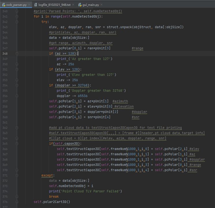

Customer wanted to save the output data in mmWave_People_Counting_GUI.exe.  He set self.saveBinary=1 in oob_parser.py.
But it prompted below error message.
Missed Frames 0/1000
Saved data file 0
Point Cloud TLV Parser Failed
He wanted to know what's the function of below judgement code in oob_parser.py.
if (az >= 128):
print ('Az greater than 127')
az -= 256
if (elev >= 128):
print ('Elev greater than 127')
elev -= 256
if (doppler >= 32768):
print ('Doppler greater than 32768')
doppler -= 65536

    BTW, could you explain the meaning of the code of the above snapshot?
    Rgds
    Shine
    My sincerest apologies for the delayed response. I am unable to recreate this behavior on my end when following the same steps. However, please allow me until the end of this week to investigate this issue further. I will respond here on Friday at the latest.
    This snippet of the visualizer's code is related to decompressing the compressed point cloud TLV. Please find more information regarding the compressed point cloud TLV in the 3D People Counting Demo User Guide.
