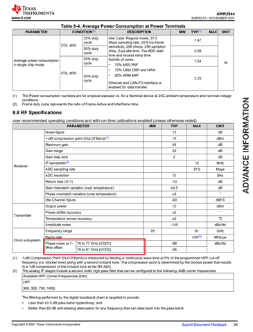

    You need to make sure that the bandwidth used falls into these ranges:
    VCO1: 76-78 GHz
    VCO2: 77-81 GHz
    Please compute the bandwidth used and make sure that the starting frequency is defined such as the bandwidth falls into the two ranges

    Q1. Does different TI mmwave module have different VCO range? For example AWR2944, the VCO2 is 76 to 81 GHz.

  • Q1. Does different TI mmwave module have different VCO range? For example AWR2944, the VCO2 is 76 to 81 GHz.
    Yes, one would need to check the datasheet for each device. There may be differences in the VCOs for different devices.
    Q2. In configuration file mrr_config_chirp_design_USRR30.h, I set the START_FREQ_GHZ to 78.76 and FREQ_SLOPE_MHZ_PER_US to 50.01
    Do I need to set any other parameters?
    No, this is sufficient to define the bandwidth of the chirp
