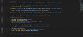

According to the tips in the previous forum, the function SOC_rcmWaitBSSBootComplete is moved before calling Bootloader_runSelfCpu. Although the entire SBL QSPI Boot Time is reduced, it still takes more than 800 ms, which is still far from our customer needs. May I ask if this can further reduce the time, Get the time down to within 250ms?
