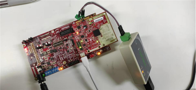

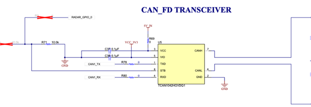

I check the automotive_toolbox_3_6_0 inside the lab0012_can_sbl and MMWAVE SDK Unit Test Procedure and I have some questions:
1. Can I use ONLY IWR6843ISK to transmit the output data via CAN (same output format as UART)?
Currently, the CAN output of radar have to be connected with MMWAVEICBOOST.
2. Can the CAN driver (provided by TI)  use in Linux if the output data is transmitted via CAN ?
