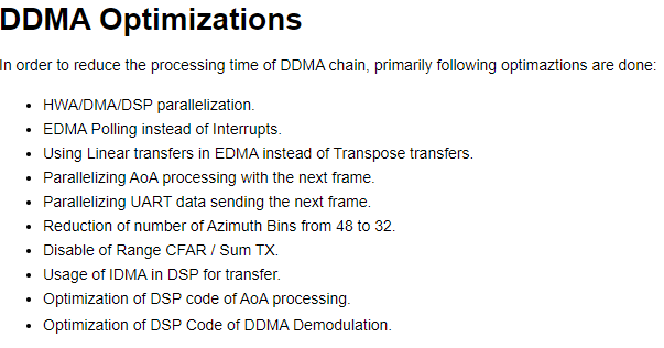

  • Hi Kaushik:
      What does the ACNT and BCNT correspond to ?
    For question (2), Can your provide more details of the optimizations before 1D-FFT ? What change in SDK4.3 to improve the timing ?
    Thanks for reply.
    Henry Lin
  • Hi Lin,
    In the FFT paramset, ACNT corresponds to the size of the FFT. BCNT corresponds to the number of Rx antennas.
    In the compression paramset, ACNT corresponds to the number of samples per block and BCNT corresponds of the number of blocks.
    You can look for the same in the following file :mmwave_mcuplus_sdk_04_03_00_01\ti\datapath\dpu\rangeprocDDMA\src\rangeprochwaDDMA.c
    Here is a list of optimizations done on the DDMA chain. (Same is available on doxygen as well)
    Kaushik
