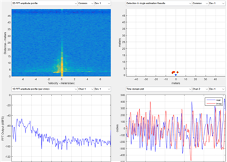

First, I was able to check the corresponding result through the mmwave studio.
For machine learning, I intend to produce the above "2d fft image" through MATLAB.
This is to be solved by accessing raw data by referring to the document swra581b (9.2).
Therefore, I modified the MATLAB Example as follows.
% return receiver data
retVal = adcData(1:4, 1:32768);
fft_out = fft2(retVal);
fft_out = abs(fftshift(fft_out));
fft_out = 20*log10(fft_out);
ADC Bits 16, complex1x, ADC sample 256, No of chirp Loops: 128, No of frame 8
I followed the above specifications, so 32768(ADC sample(256) x No. of chirp(128)) data in one frame.
But I can't see the same image in MATLAB as I saw in mmwave studio.
What is wrong?
