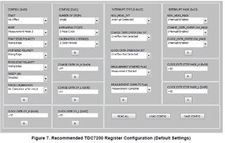

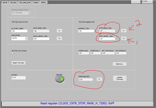

I'm using the TDC7200EVM with the MSP430 Launch Pad (MSP-EXP430F5529LP). I'm attempting to configure the options in the GUI to match those found in the manual.
However,
When I attempt to change any of these values and click the read all button (or any read button) I see that the value actually hasn't changed (I get the original value returned). I also attempted to write directly to registers 0x00-0x07 using the Debug Tab. Steps 1 & 2 below resulted in me reading the original value of xFF, where I attempted to write 0x02. I did manager to update the firmware as shown.
Is there something I'm missing? I'd like to change the registers in order to configure a test using the GUI.
Chris
  • Hey Chris,
    The EVM appears to be properly communicating with the computer since you were able to update the firmware and your screenshots show the connection.

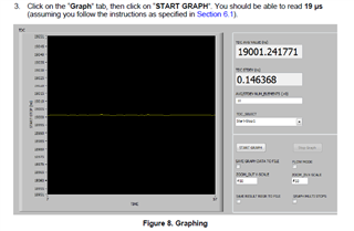

    If you toggle the "LINK LED" on the bottom of the DEBUG page, does a light go on and off on your board?  Similarly, if you go to the graph tab and click start graph does anything show up or does it give us any other useful errors?

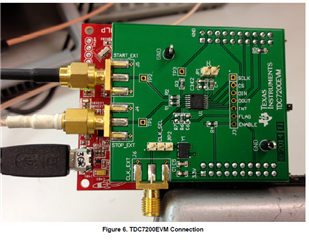

    Do you have a function generator hooked up to the board's START/STOP connectors?  I wouldn't think that this would stop the EVM from even changing register settings, but worth checking/trying.  Also make sure Jumper JP2 is connected between pins 2 and 3 so it's using Y1 as the CLOCK source.
    You can also try clicking the "RESET TDC720x" button on the GUI (debug tab) to see if that helps anything.

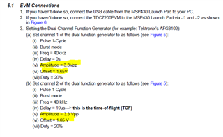

    thanks for your quick follow up. I have a delay generator set up on the TDC, its configured matching the test procedure shown in the GUI's manual. With the exception of the amplitude, I have both channels set to 2Vpp (Due to a limitation of the Delay Generator).
    From Manual
    Actual Output I see on the GUI.
    Previously,
    before programming the device with the firmware included with the GUI the graph would error out after timing out following pressing the start button. Here I see the indication that graph data is being read successfully.

  • Hi Jacob,
    I found that the TDC7200 was plugged into the LaunchPad incorrectly, it was reversed. After replacing the TDC board I'm not able to write to it, however I'm still unable to read any information from the Graph on the GUI Tab.
    I recently verified my start/stop delays using an oscilloscope, and now wondering if it could be related to my configure in the GUI.

    Just to make sure, did you put a jumper on JP1 to give the device VCC via MSP430 power?
    Another thing to check - try wiggling the TDC7200 up ~1mm from the MSP board.  I can't locate a TDC7200EVM, but with my TDC7201EVM there's a problem where if you push the board all the way down one of the connector headers shorts to a jumper on the board and causes connection issues with the computer.  Lifting it up a little fixed it.
    When I click "READ ALL" on the debug page it can read all the registers, does that work for you?  Just trying to make sure all your connection/control things work before moving onto the device settings.  Your GUI configuration in the screenshot looks correct to me.

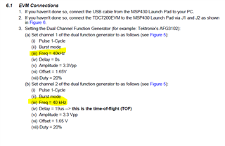

    Lastly, I did notice a problem when I followed the example in the TDC board user guide. The rate suggested by the example (40kHz) for the delay generator resulted in a glitch. I observed the start/stop pulses on an oscilloscope and see a third pulse which nearly overlaps the start pulse. It appears to be related to the recommended settings for delay/frequency; the delay being 19us and the period being 25us.

    Could you post an oscilloscope pic of the third pulse you're seeing?  Does it look like another start pulse?  Maybe try different settings, I agree it sounds suspicious with the delay being shorter than the period so maybe it's sending another pulse in the middle of the delay for the first pulse.  We're working on getting our hands on a TDC7200 ourselves to help test with.
    On your 40kHz glitch, try another frequency if you want, 40kHz isn't a requirement just a suggestion to get started.  Maybe another frequency won't have this issue.
