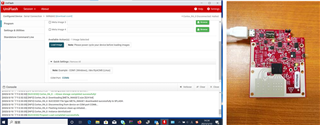

IWR6843ISK: Used Uniflash for demo flashing, but cannot detect the com port.
I asked before has not been resolved, at that time my forum was closed.
I called the customer service in China and they asked me to fill in the CPR form, but I finally found that I could not fill in some problems in my Ti account, and the time was delayed for more than a month. After completing the filling, I was told that the development module could not use the CPR form to fix it, which resulted in this anomaly and I have to ask again now.
Last time, we were told that we did not press the NRST button between the two time flashing, but actually we did press the NRST button, but the problem still occurred and we could not flash now. We really want to send it back for inspection, because it took too long, it hasn't worked since it was purchased.

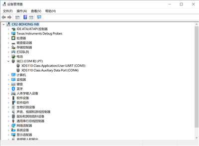

    To establish a baseline of where you are right now, can you do the following
    • verify the correct drivers are installed, like you did in the prior thread, with a screen shot of the device manager
    • start from standalone mode (ISK only) and show the switch settings
    • show the UART/uniflash errors when trying to flash the device
    We need to work backwards one board at a time to verify where the error may lie.

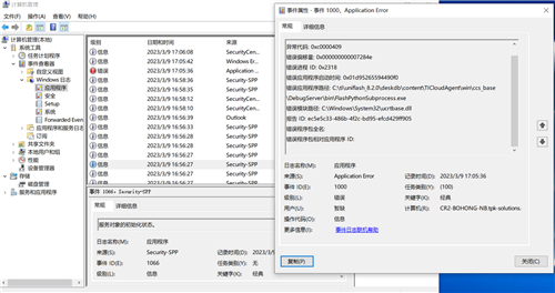

  • Hi Pedrhom,
        We tried to use three other computers to do flashing but all of them had the following error.
    Log name: Application
    Source: Application Error
    Date: 2023/3/9 17:05:36
    Event ID: 1000
    Task Category: (100)
    Level: Error
    Key words: classic
    User: Temporarily unavailable
    Computer: CR2-BOHONG-NB.tpk-solutions.com
    Description:
    Error application name: FlashPythonSubprocess. Exe version: 12.2.0.2985, timestamp: 0 x63d5bee8
    Error module name: ucrtbase.dll, version: 10.0.19041.1, timestamp: 0xbd1e2564
    The exception code is 0xc0000409
    Error offset: 0x000000000007284e
    Error process ID: 0x2318
    Incorrect application start time: 0x01d95265594490f0
    Error application path: C: \ ti \ uniflash_8 2.0 \ deskdb \ content \ TICloudAgent \ Windows \ ccs_base \ DebugServer \ bin \ FlashPythonSubprocess exe
    Error module path: C:\Windows\System32\ucrtbase.dll
    Report ID: ec5e5c33-486b-4f2c-bd95-efcd429ff905

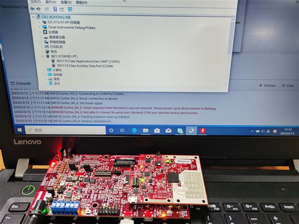

    When you go to device manager does the two COM ports show up? Rather than have all three systems connected at once, let us go one by one. Your 6843ISK EVM has a USB port of its own. Are you able to flash the device with it in the proper flashing mode, USB cable connected from EVM directly to computer with no other attachments, with the correct COM port set? You will need to change the mux switches to the correct mode for flashing mode

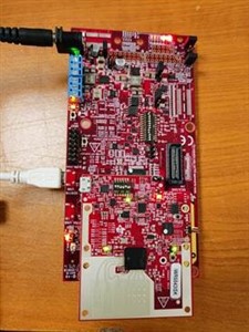

  • Hi Pedrhom,
       We tried to flash with IWR6843ISK  and it  flashed normally.
     However, we tried to use IWR6843ISK + mmwaveICboost and failed to flash properly.
  • mmwaveisboost
    switch code: off, on, on, on, on, on, on, off, off, on, on, on
    IWR6843ISK
    switch code:on, off, on, on, off, off
    The switches you have for the ISK is correct for standalone mode flashing, however for flashing using a ICBOOST attached the switches will need to be different.
    After, when you add the ISK board to the ICBOOST, and then attach barrel jack as well as plug usb cable into the XDS110 port of the ICBOOST, the COM port will change. Did you adjust the COM port being flashed to in Uniflash to reflect this change?

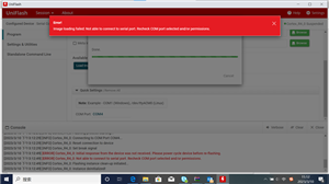

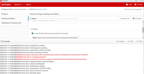

  • Hi Pedrhom,
          We have tried the method you suggested, but it was also unable to flash in.
    Please give us further instructions. Thank you.
