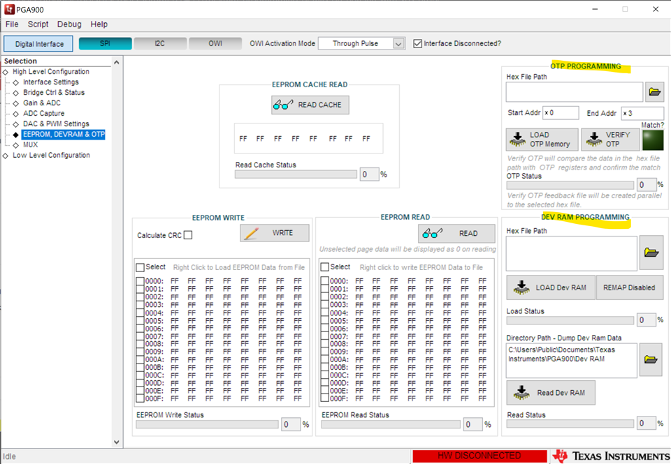

This question is related on another one I posted on the Sensors forum. I want to program my PGA900 on its EVM board with an XDS probe, like it is explained on the controller's docs. However, I want to only program on DEVRAM, and leave the OTP blank while I'm testing my code. I made a mistake and accidentally programmed the OTP memory on my previous PGA, but I can't tell if I made this mistake while using the Windows GUI app, or then with CCS and the XDS probe (see my post on the sensors forum for the details of what I did). So, because I don't want to accidentally program again on the OTP memory, I want to be sure of a few things on CCS.
Firstly : What do I have to do on CCS to write my code only on the DEVRAM memory ? I edited the .cmd file for the linker so that all the sections originally allocated to OTP are now allocated on DEVRAM. Is that the right thing to do, and is there something else I have to do ?
Secondly : After successfully linking to the PGA900 with CCS and the probe (I know it works because I could read the memory content and the registers), I tried to load my compiled program. However, I got a memory check error : "Cortex_M0_0: File Loader: Verification failed: Values at address 0x21000003 do not match Please verify target memory and memory map.". I suspect it might happen because the OTP memory was already written at that time : am I right ? If I try to load again my program on this failed PGA, I get the same error.

    Yes, I definitely used only the devram buttons. That's why I don't understand what happened with the OTP. I find it simpler to use CCS so that's why I am now asking questions on how to properly program the DEVRAM with CCS.

    When I started programming with an XDS probe, I modified the .cmd file in the project, because by default, when building, all the program was linked to the OTP memory address and not the Devram's. But, I missed something in the .gel file in the target configuration : with this file, the REMAP register is activated when connecting to the device, which means the Devram's address was changed to have the OTP's.
    So basically, I changed the content of the .cmd file "to make sure I upload on the right memory (according to my understanding at that time)", but in reality this change made sure I was programming on the wrong space every time because the memory swapping was already happening thanks to the .gel file. If I had left alone the .cmd file, everything would have been fine from the beginning.
