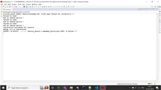

    We also tried the steps exactly mentioned in the user guide, including flash empty example appimage, then loading rfs binary into 0x21208000 adress location. Still my code is getting stuck at same place with same error as shown below.
    Calibration Validated for restore
    Debug: CLI is operational
    ASSERT: 0.35311s: ../../../motion_detect.c:mmwDemo_factoryCal:2496: 0 failed !!!
    Vishnu
