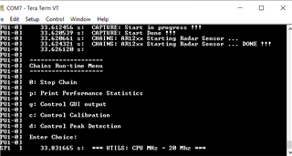

I'm succesfully ran processor SDK's cascaded AWR1243 demo on the board on RTOS. (With some code changes as mentioned in some other posts)

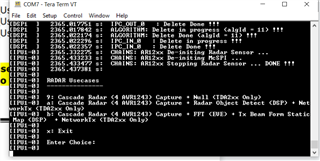

However, When testing to display the "a: Cascade Radar <4 AWR1243> Capture + Radar Object Detect <DSP>" ethernet output on example matlab code:
I got this error.

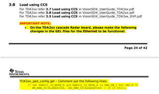

I suspect that's because I didn't do the following step mentioned in the yellow marker so the ethernet port isn't functional.
Question1: If I boot via sd card, is this step required?
Question2: I failed to find this TDA2xx_pad_config.gel, where could I find it and change it?
