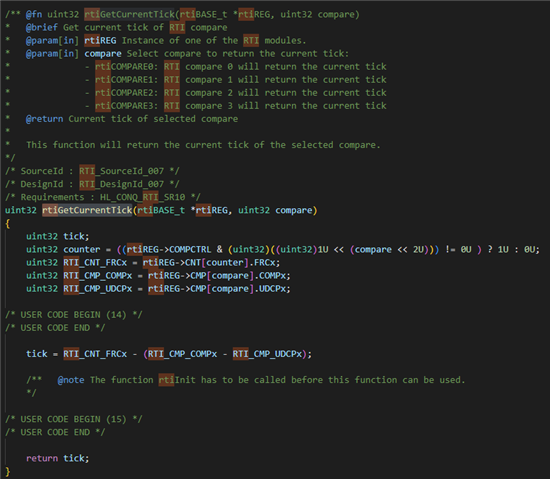

The following figure shows the RTI-related code generated using the HAL tool:
When fetching the RTI current tick, tick = RTI_CNT_FRCx - (RTI_CMP_COMPx - RTI_CMP_UDCPx)

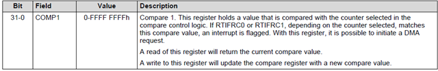

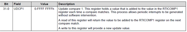

Why the above design? From the customer's understanding, the values of RTI_CMP_COMPx and RTI_CMP_UDCPx should be consistent because the UDCP values are loaded into the COMPx registers, please see figure below:
Could you help check this case? Thanks.
