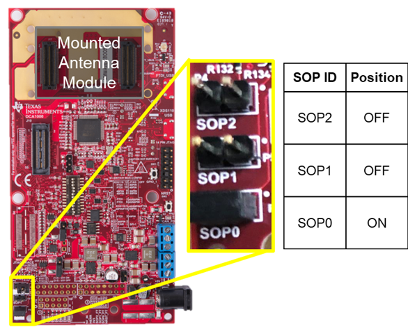

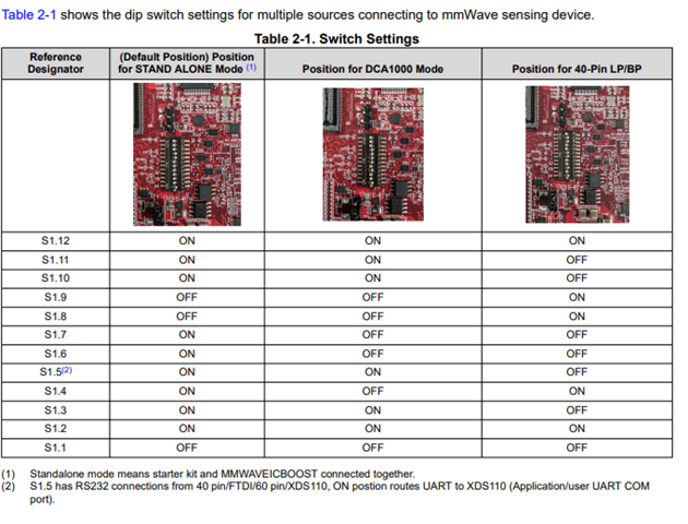

The switches on the MMWAVEICBOOST were initially configured as follows:
To read data from the J6 header for testing, I switched the 3 switch to off. I tried to send and receive data from the J5 header using both of these switch configurations with no success.
Is there anything required in order to setup the MMWAVEICBOOST board to receive and transmit configure and start/stop commands and their associated responses on the J5.5 and J5.7 pins? I am able to communicate with the board from a computer via the USB but not through the UART pins.
