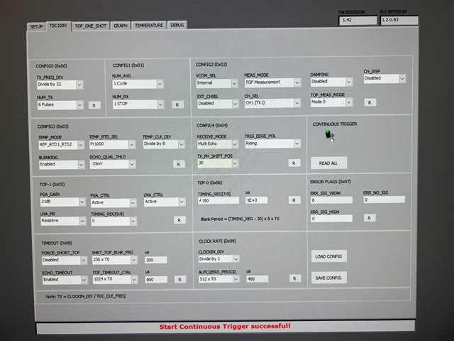

I am using mode 0 of the TDC1000 with the settings in the screenshot below. Unfortunately I cannot get an echo and the TX signal rings and then is pulled up to some DC level it seems.

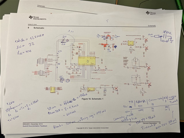

I have made the following mods on the EVM:
- Changed filter to include only an RC low pass with 100kHz cutoff (100R, 15nF)
- Changed to use external clock set at 1.28M --> 1.28M/32 = 40k
- Changed series resistors on TX path to 500R
- Replaced RX paths series capacitors to resistors of 1K. (for LNA gain of 9)

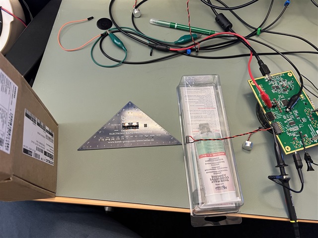

The setup. Distance to box is never detected no matter what settings are used, tried bypassing the LNA, PGA, changing gains, timing. What am I missing? Does anything on the evalboard need to be changed? Is a simple low pass filter not enough and should I implement a bandpass?

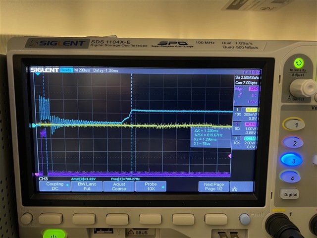

Using CT10U-30S400-1 . Yellow is the buffered COMPIn signal. on the EVM. Blue is directly on the TX output with transducer connected. Purple is start line.

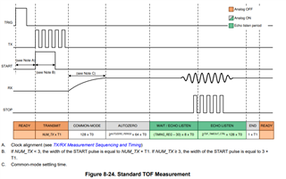

    If you setup your filters correctly its possible that the configuration for the echo listening window may be incorrect, so please ensure that the device is checking for echoes at the right time. Probing the COMPIN signal will give you visibility if you are getting a return echo on the transducer. Another recommendation would be to increase the number of pulses transmitted during a burst, this will help you increase the energy transmitted and increase chances of detection, this can help you determine if your configuration is working correctly. If you need assistance configuring the echo listening window please provide some info on detection range I can help ensure your settings are correct.
