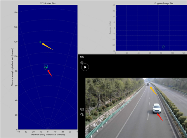

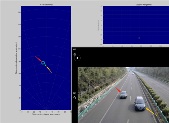

    Test medium_range_rada target number mismatch, meaning that when 2 or more cars are coming, some vehicle targets do not have prism, square clustering, and tracking target markers on the visualizer and only one point is moving.

    As shown in the left Figure above, the left vehicle displays the tracking target marker and the right vehicle shows only one point.
    As shown in the right Figure above, the truck at a distance shows only one point, and the trolley at the near end has tracking marks.
    If set not to display point-cloud data on the Visualizer, only the tracking target will be displayed, it will result in missed detection of the vehicle. How to fix this?

    I will start with a little bit of detail on the tracker in Traffic Monitoring. I am almost 100% certain that with the tuning of tracker CFG parameters you will be able to have better range resolution to distinguish two different cars from each other, and allow cars that are farther way with a lower SNR to still be considered a track. The tracker algorithm used is the same that is used for 3D People Counting. That lab is for 6843 only, however the documentation covering the tracker layer parameters is still identical so I would start by going there. I would try changing stateParam and allocationParam in order to make the tracker more sensitive and better fit your environment. The default configuration is for tracking vehicles around 70 meters away and we can see with the current configuration it struggles to track a vehicle at 120 meters.

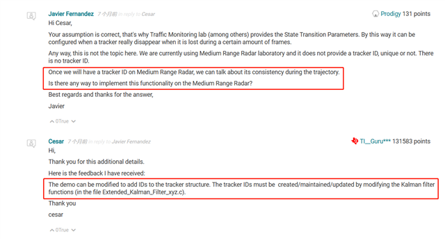

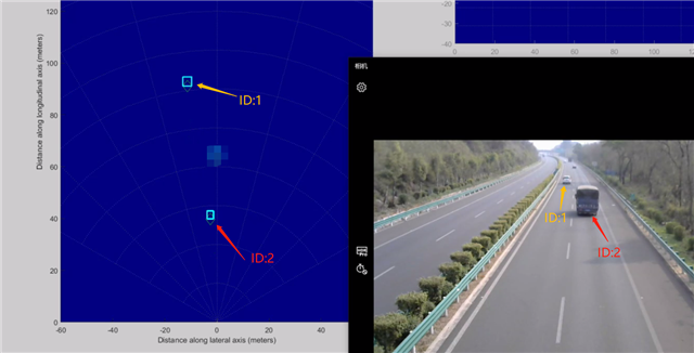

    It is used in traffic monitoring to assign an ID to the monitored vehicle, the same ID keeps track of the same vehicle until the vehicle disappears in the radar detection range. As shown in the figure below, the customer wants ID:1 and ID:2 to follow the same vehicle at all times. Currently MRR demo can export detected vehicles. If they want to add an ID to the vehicle and track the vehicle until the vehicle disappears, is it possible? If so, how to implement it?

    1. You will need to move over the tracking algorithm itself which includes the trackingproc files and gtrack files.
    2. Tracker algorithm in Traffic Monitoring already gives a track id (tid) per track, it is just not being visualized. You can get an idea of everything that can be outputted in the Understanding UART Output TLV guide
    (https://dev.ti.com/tirex/explore/node?a=1AslXXD__1.00.01.07&node=A__AB9hZpEHkevINfCz6VJgQw__radar_toolbox__1AslXXD__1.00.01.07)
    The link covers the industrial demo TLVs and does not have the MRR ones but there are four and work in the same way. You can see MRR's TLVs in the mss_main.c. "CAN_MESSAGE_MMWDEMO_TRACKED_OBJECTS" will have the values listed in the MRR user guide and for every TLV that comes in you can give it an index.
    I will add the MRR and Traffic monitoring although similar in end result are built very differently from each other, so there is no easy way of turning one into the other, it will require porting of code. The tracking algorithms are different between the two demos as well.
