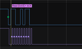

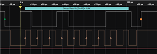

Slave address is 0x48 and so the byte transmitted in the I2C message is 0x91.
So in short, I initialize the I2C parameters and then wait for an I2C message from the master (my MCU). After I give the message I receive a NACK signal from the sensor however.
Is there something obvious that I am doing wrong?
thanks

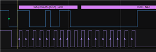

    I am using code taken from the I2C slave driver in that post and the example is in I2C master mode which I haven't managed to figure out how to extract any valuable info from.
    I suspect the UART task in the people counting demo is messing with my I2C code somehow, maybe the semaphore.
    Inside my while statement where the I2C is blocking, when I send the message from my master MCU, the sensor code continues which indicates that the I2C blocking part is working as expected. It's just that I get the NACK.
    So, sensor code is halted here:
    I2CSlave_read_write(i2cHandle, rxData, txData, 1);
    until I send the I2C read command with my master MCU, at which point the sensor code runs again.

    Edit: It turns out that when I try to communicate with other I2C devices (eeprom on address 0x50) on the same line I also get a NACK (when the mmwave sensor is online). My main board also has pull-up resistors at 4.7kΩ (as mentioned in my original post) but the ISK board has its own 10kΩ ones:
    I removed my 4.7kΩ but the issue persists. My main board also runs on 3.3V.
    On my test code where I added the I2C part to the People Counting Demo I get this:
    and on the I2C demo I get this:
    where the code is blocking here: retVal = I2CSlave_read_write(i2cHandle, &rxData, &txData, 1);
    As you can see the CLK line goes low and stays there until I reset my MCU. (I changed the address to 0x65)
    thanks

    I made some adjustments to my controller I2C code and I can successfully run the demo now.
    I am still getting the NACK in my People Counting project however and I can't find the reason why.
    Here's the main file:

    In my code I had this:
    arg = 1;
    errCode = I2CSlave_control (i2cHandle, I2C_CMD_ADDR_MODE, (void* )&arg);
    but arg should be 0 for 7 bit mode (1 is for 10 bit mode).
    After changing that I get this after one I2CSlave_read_write:
    Both lines stay down after the ACK. I'll try isolating the UART somehow but isn't it necessary to get the chirp config file through the Visualizer?

    I've tried isolating the tasks with no luck as I don't have any experience with TI's MCUs. I'll try again..
    The bug from the post you provided mentions the I2C lines going low after consecutive I2C procedures while mine happens on the first one.
    thanks
    Could you try making the meat of your I2C code in the c file you listed above (near) exactly what the slave.c example file does and see if it works? I notice you add in a Task_sleep(1000) and a couple other things. If the exact same code doesn't work then there might be a deeper issue with the SDK.
    Also, try and change the slave address from 0x65 to something else, and be sure this is reflected back in your I2C Controller code.
    Let me know if this helps.

  • Haven't managed to make it work. Here's my test code:
