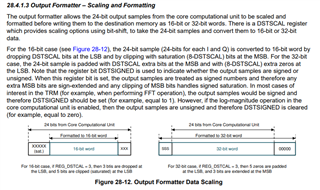

Hi Experts
Customer would like to know what’s the meaning of srcScale and dstScale when configuring compression param-set on AWR2944.
As shown in below codes. I did not find any description in HWA user guide compression addendum regarding to srcScale and dstScale.
Could you pls help elaborate what's the meaning of these params and if we need to modify it in customer's app?
Ken
