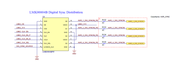

Hello Abhed Misra,
Do we really need the second LMK00804B?
Besides the 40MHz, LMK00804B is also used for Sync. But the Sync frequency is really low.
Could we use low-cost circuit such as transistor or mosfet to replace LMK00804B?
Thanks in advance.
Dear Huan -
Sorry for the delay in responding and welcome to E2E. Please refer to page 3 of this application note to see the importance of using a dedicated fan out IC for the sync signal distribution.

Huan -
I am not sure why you keep rejecting this answer, which is yes - Please refer to page 3 of this application note to see the importance of using a dedicated fan out IC for the sync signal distribution.
