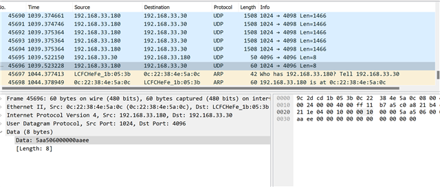

I am trying to capture IQ data using DCA1000EVM and IWR1642BOOST. For this, I used OOB Demo and CLI tools provided. I used UDP functions provided in MATLAB to read data.  After around 1.5 -2mts  the transmission from DCA stops  (the first LED on the corner of the DCA  board stops blinking, it's always high.  No data received on the host.- checked in wireshark)
FrameRate is 1hz and Packet Delay is 100 us. "captureStopMode" is set as infinite"
When check in wireshark, looks like somehow the DCA is getting a STOP command packet. I am not sure how is this command getting send, I didnt invoke stop_record at this point.
Is there an implicit condition this can happen?

    I am using StudioCLI.
    json file

  • I used the json file in mmwave SDK user guide.  From the datasheet available at "mmwave_studio_02_01_01_00/mmWaveStudio/ReferenceCode/DCA1000/Docs/TI_DCA1000EVM_CLI_Software_UserGuide.pdf"
    I understand when captureStopMode is set to infinite, other params in captureConfig shouldn't take effect
    I am able to stream data continuously if I just use "file writing ". If I try to open a udpport to same port in parallel, only then after 2mts stop command is send. I am trying to understand why is this stop command being sent.
