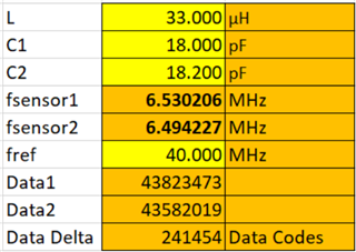

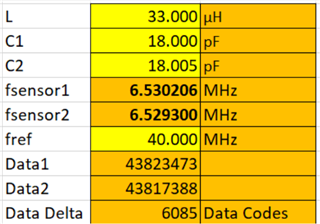

    Please see the calculations below that show the expected ADC code delta with a 5fF change in capacitance.  I have also included the delta on the full 200fF range.  This does not take into account the noise floor which will be system dependent.  An increased RCOUNT value will provide better signal to noise ratio, but at the expense of longer time consumed.  RCOUNT should be set to provide the appropriate SNR and scan rate for your system.  When calculating the time, you need to take into account sensor activation time, conversion time, and channel switch delay.  Section 9.3.2 of the datasheet describes how to calculate each of these for your system.
    5fF delta
    200fF delta(full range)

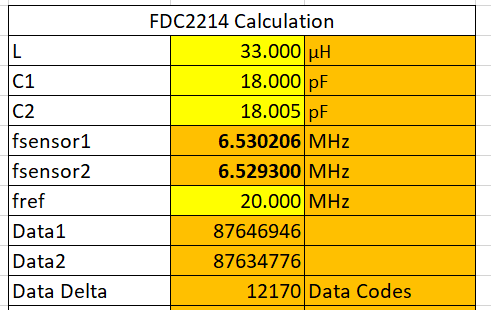

  • Shane,
    I have attached the spreadsheet with formulas.

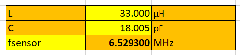

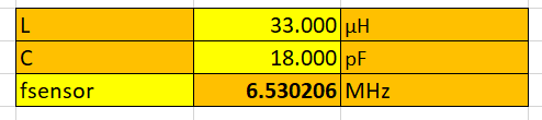

    The cells below shows fsensor resonant frequency when there is no change in capacitance.
    The cells below show fsensor after a 5fF change in capacitance.
    We can then convert each frequency into the resulting data codes of the ADC using the formula you show.  Results are shown below.
    The data delta means that for every 5fF change, you will see a change of 12170 data codes using the 28 bit ADC of the FDC2212.  As mentioned before, this does not include additional noise floor from your environment.  Even with some additional noise floor, this should be sufficient for a 5fF step size.  LC Calculator for varying C.xlsx
