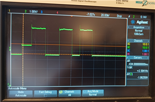

when using the standard PGA305 labview run time module from TE, the OWI activation pulses are as in the manual "PGA 305 signal conditioner and transmjtter for pressure sensors - SLDS231" page 24 . 2 pulse sequence with  Pulse ON 10 ms, OFF 20 ms , delay 110 ms

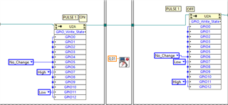

1. When trying to activate the OWI directly from own Labview Program -  the Pulse ON and OFF time duration change with each execution and OWI is not activated.
Vi property  -Execution set to high priority.
used "delay" , "ms wait" , " high resolution polling wait " .vi in labview
part of code:
output from oscilloscope - pulse sequence 1
this varies with every run,
can you please suggest a way to get tigger pulse duration correct with Labview .

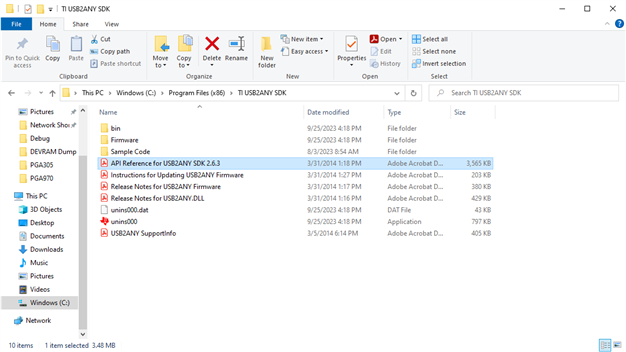

    Unfortunately TI has very limited resources for helping you with respect to code.   I currently do not have access to the LabView VIs for the GUI to help determine how the OWI activation is commanded on the USB2ANY.  As the USB2ANY communication is HID, this is probably a bigger issue than the LabView portion.  You could review the USB2ANY documentation to see what can be done here.  There is an API reference for USB2ANY located in your install directory:
    Included in the reference are the function calls for OWI stating in section 5.16 on page 73.
    This thread may also be helpful.
