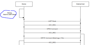

i guess the flashing process via UART is being stopped here, when UNIFLASH sends interrupt signal to IWR6843, it gets no response or wrong response from IWR6843. I used an oscilloscope to measure pulses from the IWR6843AOP circuit board and the circuit board I designed myself, the results are as follows:

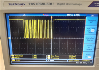

  • The pulse I measured is from the UARTA_TX pin of the IWR6843AOP board
  • The pulse I measured is from the UARTA_TX pin of the circuit board I designed
=>The pulse measured from the IWR6843AOP circuit board responding when receiving a break signal from UNIFLASH is different from the pulse measured from the circuit board I designed myself.

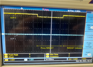

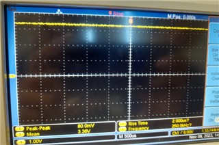

  • Thanks for the feedback

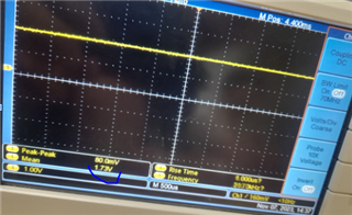

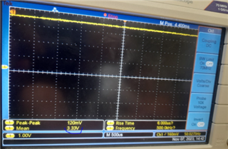

    I used an oscilloscope to check pins SOP0, SOP1, SOP2 in flash mode and the results are as follows:
    SOP0 = 3.36v:
    SOP1:
    SOP2: 1.8V

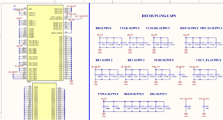

    Below is the power supply schematic:
    I look forward to receiving your help as soon as possibleGrinning
    Tu Tran

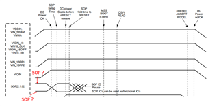

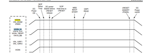

  • Hi Tran,
    Please capture the SOP and power signals during NRESET release along with the RESET signal. The above captures are once these signals are stable and won't help in determining if the correct bootmode is latched.
    Ankit

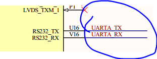

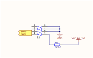

    Can you explain specifically to me where SOP0, SOP1, SOP2 are in this drawing?
    I will check and give the results as soon as possible
    Tu Tran

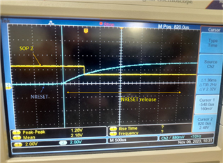

    It would be helpful if you could capture SOP0 and NRESET signal and SOP2 and NREST signal individually as you can measure only two signals at a time. The NRESET release will be in microseconds, so we should set the timeframe close to 20-40us and trigger the oscilloscope for rising edge of NREST signal probe.
    For the drawing there is no specific SOP2,1,0 it's just a depiction of SOP signals and can be set high or low according to the bootmode selected. The important part is that during the reset release all the SOP signals are stable.

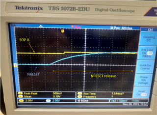

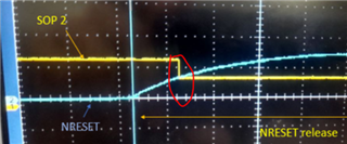

    I measured at the two signal ends NRESET, SOP0 and NRESET, SOP2, the results are as follows:
    + NRESET, SOP 0
    + NRESET, SOP 2
    Tu Tran
  • Tran,
    Yes, the wrong bootmode is being latched during NRESET release. Hence, you are unable to flash your device. Also, it appears some signal to be driving the signal when reset is released. The SOP2 signal should not drop when reset is released. As during reset release SOP2 is below threshold voltage of 3.3V incorrect SOP mode is set.
    Please provide the schematics, so I may review and let you know.
    Also, it appears that the SOP signals capture shared before seem to different from what is shared now. Could you please confirm.
    Ankit

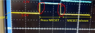

    I'm very grateful for your feedback

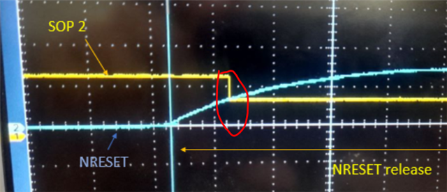

    I will explain more about this photo:
    =>The yellow signal is SOP2, the blue signal is SOP0. I measured these two signals at the same time, the yellow arrow (Press NRESET) and (NRESET release) is the time I pressed the nRESET button and released it on my circuit board.
    In the picture below, I measure 2 signals at the same time: yellow is the SOP2 signal, the other color is the signal at the NRESET pin.
    Do you mean that during NRESET release, the signal at SOP2 must not drop and must be at 3.3v for the device to go into flash modeWink?

  • Tran,
    Thanks for the explanation. But SOP2 must not drop and be 3.3V for the device to go into flash mode.
    I will check the schematic and provide the feedback.

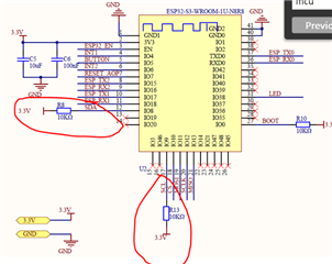

    1. My purpose is to use RESET_AOP to USE the ESP32 chip to trigger iwr6843 reset. But in my design I still haven't soldered the RESET_AOP block onto my circuit board. so I'm sure RESET_AOP doesn't affect the measurement results.
    2. at SOP2 when applying power I always measure 1.8v, I don't understand why. i tried checking my circuit board and sure enough the sop2 generator is not connected to the 1.8v of the PMIC. Is there any reason when creating sop2 I always measure 1.8v instead of 3.3v?
    3. According to your opinion, when sop2 enters flash mode, there is always a voltage of 3.3v, is that correct?

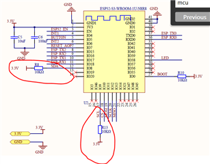

  • Hi Tran,
    Please check below. Although the MCU is not soldered same nets of SDA and SCL are pulled up by the 3.3V instead of VCC_IO or PMIC_3V3. Hence its, booting up the device although when VCC_IO is not present.
    3. Yes, hen sop2 enters flash mode, there is always a voltage of 3.3v.
    The SDA and SCL nets going to the 6843AOP device must be pulled up by PMIC_3V3 and not 3.3V from LDO. Please try depopulating R8 and R13 and tie to PMIC_3V3.
    Ankit

    1.All the components below I have not soldered to my circuit board,
    Therefore, SCL and SDA should always use PMIC3.3v power:
    .I will send you back my design, in this version I have marked the actual soldered components on my circuit board. Could you please check again, sorry for the inconvenience.

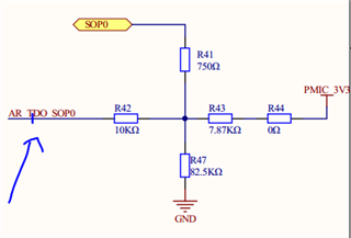

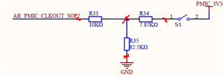

  • Hi Tran,
    I went over the schematic; I could not find any signal that could be pulling down the SOP2 signal to 1.8V from 3.3V. Would you kindly assist me in measuring the resistors below and provide their values?
    R41, R44, R47, R42 and the junction.
    R33, R34, R35 and the junction
    Ankit
