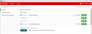

SBL project: C:\ti\MMWAVE_L_SDK_05_03_00_02\examples\drivers\boot\sbl\xwrL64xx-evm
Uniflash
Meta Image 1: sbl.Release.appimage
Meta Image 4: C:\ti\MMWAVE_L_SDK_05_03_00_02\examples\mmw_demo\mmwave_demo\prebuilt_binaries\xwrL64xx\mmwave_demo.release.appimage
