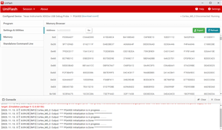

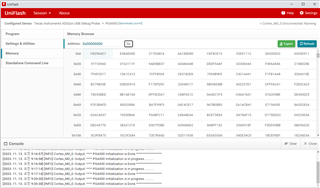

    Before you reply, I would like to let you know that I did one more thing.

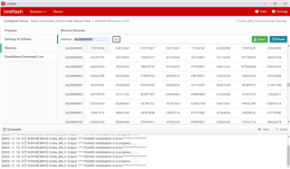

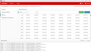

    When reading memory with uniflash, the following code is contained at address 0x0.
    What's strange is that 0x20000000 also contains a code.
    Please check if this is one of the reasons it is not working now.
    And every time I reapply the power and read the memory with uniflash, the values in the memory (both 0x0 and 0x20000000) keep changing.

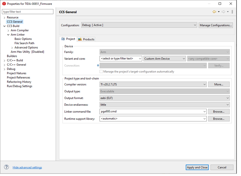

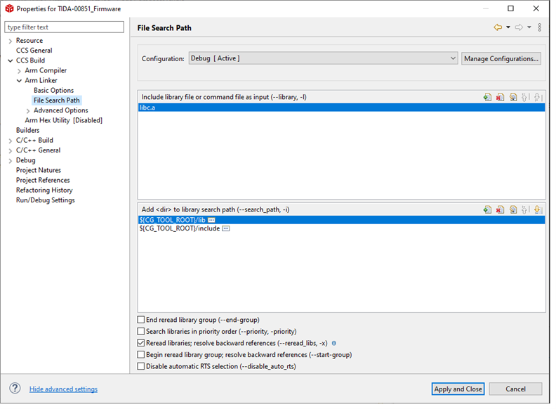

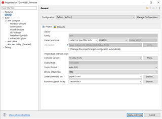

    As to the code, you will need to make a change to the build procedure in CCS.  The library included with the source code is from an earlier compiler so it should not be used.  Instead, under the project properties make the following changes to match what is shown below:
    And remove any additional library include paths except the libc.a library.

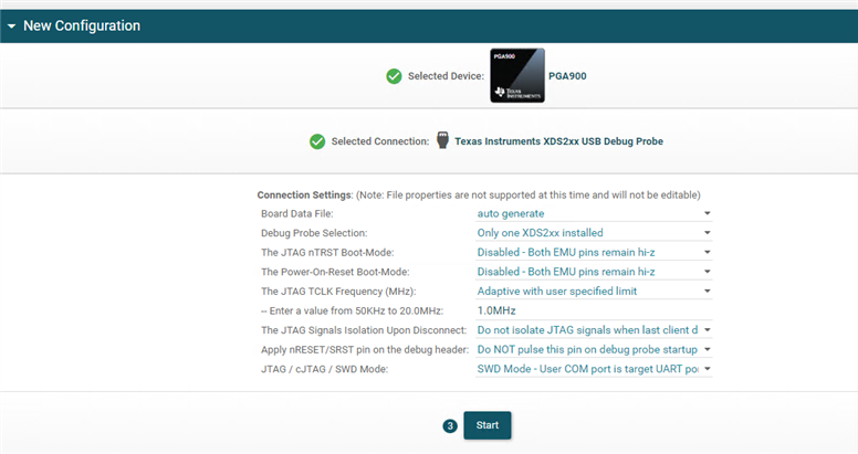

    When using Uniflash, make sure the properties match for the device configuration as follows:

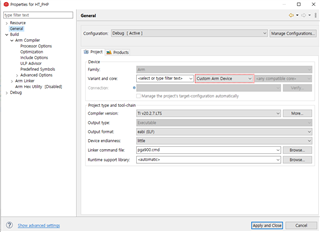

    The various options in my CCS General are as follows:
    I edited it like the picture you sent.
    The parts I changed are marked with a red square.
    Change PGA900 to custom arm device in variant and core.
    The arm linker's file search path is the same as the image you sent.

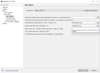

    When I modify PGA900.cmd as follows and build, the following warning appears.
    If you change the red box in the arm linker's basic option from blank to 0x800 and build, the warning will disappear.

    The Connection Settings of uniflash are the same as the settings you sent.
