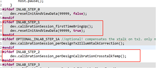

    This is my calibration procedure:
    1,Set the working mode to Super-HDR,Create OPT3101_configuration.cpp file
    2,Replace file in SDK OPT3101_configuration.cpp
    3,Open conditional compilation INLAB STEP 1
    4,Use UniFlash to update firmware
    5,Calibrate according to OPT3101 SDK Users Guide
    Use black electrical tape to cover the photodiode
    6,Calibrate internal crosstalk
    7,corrects for crosstalk and phase offset
    phase offset calibration in this step requires the target to be set an a specified distance:10mm,20mm,80mm,120mm;
     Use a white background as a reflective surface
    8,Phase offset calibration complete,The read distance is abnormal

      I am sorry about the delay, it took soime time to find and understand what you were seeing and replacate your problem, them find a solution. This is what we believe is your problem and solution.
    In HDR mode, the current can switch between 2 current settings on one TX channel, and with super-HDR, TX1 can be used to add 2 more current settings.
    What we think is going on here is that the phase offset measurements are not being done at the proper amplitude for each current setting.
    The documentation recommends doing phase offset calibration at a target distance where the amplitude is between 16000-24000. The preset values in the SDK are arbitrary and definitely don’t follow this rule. The values are set like below in OPT3101Coefficients.cpp.
    void environmentalController::manuallySetReferenceDistances(){
           this->refDistancesInMM[0][0]=50;
           this->refDistancesInMM[0][1]=120;
           this->refDistancesInMM[1][0]=60;
           this->refDistancesInMM[1][1]=150;
           this->refDistancesInMM[2][0]=0;
           this->refDistancesInMM[2][1]=0;
    The indexing on refDistancesInMM is [Tx channel] and [current setting, 0 being H and 1 being L]. In order for them to find the proper distances to set for each current and tx setting, you will need to change your configuration to do just one current, flash that, and see at what distance you can get 16000-24000 codes for that particular current. At higher currents, that distance will be pretty far with a white background, so you can use darker backgrounds in order to get lower amplitude settings, but they’ll need to remember what current settings used what color background when you do the calibration.
     Once you know these distances, you can enter that into OPT3101Coefficients.cpp and then use super-HDR configuration and perform the calibration.
    This method is used to get extended range because it moves the IQ data calculations into the other quadrants. For more information look up IQ demodulation techniques.

    I have tested and completed the calibration function of INLAB_STEP_1 and carried out the next calibration. I have a question to ask:
    1:Whether the phase offset parameters after INLAB_STEP_1 calibration are stored in the MSP430F5529LP during INLAB_STEP_2 step calibration;
    2:To estimate the environmental phase offset coefficient, bright environmental light sources such as halogen lamps are needed, and can be replaced with LED light sources
    3:For phase offset temperature test and lighting crosstalk temperature test in the hot chamber, there are no requirements on air humidity
  • Pengsheng,
      In the OPT3101Coefficients.cpp file in the SDK is the location that you will insert the results from each step of the calibration sequence. No the data is not saved automatically. You will need to capture it in the UART window where the feedback is presented, then inserted into the the calibration file. This will need to be done for each step of the calibration.
    The purpose of the Light is to represent strong ambient light or sunshine. You need about 100k LUX of light. The EVM has a photodiode with IR pass filter and an LED has a narrower bandwidth than sunlight. You should use halogen because an LED won’t have any IR.We recommend halogen lamp due to matching close to sunlight.
    The only time humidity will impact light measurments is 90+ percent humidity (97-100 is fog, rain or under water) We recomment less that 80 percent humidity for the calibration.

  • Gordon:
    What I mean is that when I execute INLAB_STEP_1 in OPT3101 SDK, the calibrated phase offset parameters are saved in MCU FLASH. When I perform INLAB_STEP_2 step calibration, will the previous parameters in FLASH be erased;
    I have another question:
    Test the OPT3101 SDK INLAB STEP 4
    Serial port output:Set Ambient light to 0lux
    How to set 0 Lux?
    Thanks!

    For step 4 ambient cal Look at 3.6.3 Phase offset Ambient coefficient in the how to calibrate doc. It does not mean to mask the photodiode. You need to sweep ambient light from 0 to max (see Figure 7. Phase offset vs Ambient data)
    The SDK only erases when the writeToFlash/EEPROM command is called. I believe SDK is by default storing in local file on the PC assuming they are running SDK on windows PC. And then load calibration functions called it writes the file values into 3101. There is a flash in the calibration functions if you want to saveToFile or use EEPROM.

    OPT3101 EVM 中添加了 24C02 EEPROM。测试步骤INPRODCTION,工厂调整,工厂模式安排完成,调整参数保存EEPROM中;但工厂调整只在调整了相移,例如灯光串干扰温度系数、相偏温度系数、相位环境系数需要软件加载到SDK中,尚未写入EEPROM。请问如何将这些参数写入外部EEPROM?OPT3101通过什么方式可以在上电时自动从EEPROM中加载这些保存的参数;
    我使用外部化EEPROM测试了工厂模式调整,dev.resetInitAndViewData(99999, true);函数中的参数必须为true,否则串口打印的距离数据不正常。
    查看OPT3101数据手册,支持上电自动加载EEPROM中存储的调整参数,我的理解是在外部EEPROM的情况下不需要软件加载这些参数,只需要通过IIC读取相位数据,计算距离;
    谢谢!
  • Pengsheng,
    SDK does not write/load the system level coefficients to EEPROM because these values should not change across devices so won't need to change values in OPT3101Coefficients.cpp when loading firmware to a different unit.
    The EEPROM is read by the OPT3101 on device reset and the device loads the EEPROM values into the registers. More detail in page 32 of the datasheet.
