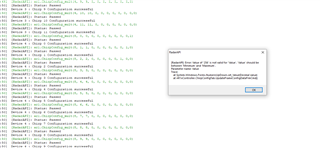

Hi, I get the following error when increasing the number of chirps per frame in MIMO mode. Where can I find maximum and minimum, and is this a limitation of the hardware or is it due to other configuration parameters?
Post below indicates that the max is 255, why is that?
You can find the restrictions for all of the various APIs in the Interface Control Document. The maximum number of chirp loops in legacy frame is 255, this is a HW RAM limitation.
The Interface Control Document is part of the DFP (Device Firmware Package).
