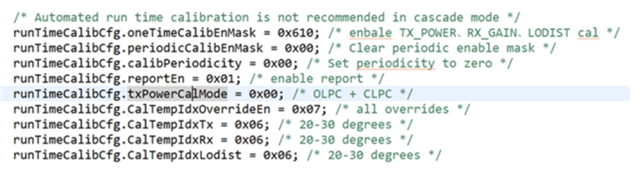

(1)Run time config:

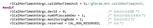

(2)CalMonTimeUnit:
In the MMWL_App function , after the completion of RfInit, the MMWL_RunTimeCalibConfig function is called in the MMWL_DeviceConfig, as shown in the diagram below:
At this time, the master-slave (2-chip cascade) Run time Calib Report will be triggered (we believe this is correct)
