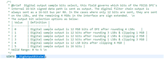

, but I seem to also be unable to decode the raw data produced by it. I also noted that this GUI capture does not work if the data format mode is set to 16bits (whereas it performs a capture if set to 12 or 16). The DigOutputBitsSel config value is set to 5 i.e. it outputs 16 bits as described in the header file:
is this a possible issue that is contributing to my decoding woes?
