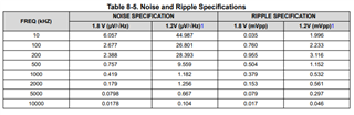

Hi Expert,
Is there IWRL6432 ref design with 1.8V/1.2V power supply?
Daniel
Hi Expert,
Daniel
Hi Daniel,
Thanks for your inquiry. No, we don't have a IWRL6432 reference design utilizing the 1.8V/1.2V power supply topology.
However, you can use the reference page 5 of the IWRL6432BOOST schematic and design files and pages 19-21 of the IWRL6432 Datasheet starting place. The EVM uses the 3.3V/1.8V/1.2V topology and steps down 5V into the needed rails. However, in your case, you would simply use the 1.8V/1.2V converters. Just make sure to route the power to the appropriate IOs listed in Table 8.3 of the datasheet. No matter what power topology or DC/DCs or LDOs you use, please take care to ensure the noise and ripple specifications laid out in Table 8.5 of the datasheet are met.
