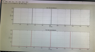

I meet some trouble when i use IWR6843aop and dca1000 to collect data under CW mode.
I set digOutSampleRate 2000kps,complex,I first.Then i read the data with matlab,i find the I or Q data 1028 point is a cycle,the first four numbers are all 2047.
It makes me wonder if I've configured it wrong.I would like to know what is the data format of 6843 and DCA1000 in CW mode configured by mmWave studio.

    We read the doc and refered the format,LFMCW wave config is ok,however CW mode is still have 8 point unusual.You can try it.

    Is the dataTransSize of Contimode fixed in mmWave studio? Is the unexpected data in captured ADC data is related to this?
