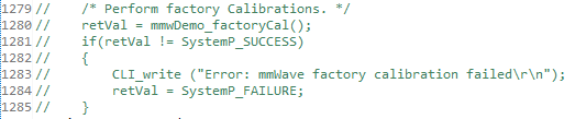

IWRL6432: Factory calibration error
Part Number: IWRL6432
Other Parts Discussed in Thread: UNIFLASH, ,
During bring-up custom board, error occurs with factory calibration.
My environment is like below
  • HW: Custom board
    • Flash memory is changed
    • Temperature sensor are removed
    • There is only CAN interface, no UART.
  • SDK L: 5.3.0.2 version
  • Example: Motion and presence detection demo
  • Configuration: MotionDetect.cfg is hard coded

Error: FECSS RF Power ON/OFF failed
Error: mmWave Control Initialization failed [Error code -203227134] [errorLevel 2] [mmWaveErrorCode -3101] [subsysErrorCode 0]
Exception: ../motion_detect.c, line 4046.
ASSERT: 3.6337s: ../motion_detect.c:mmwDemo_factoryCal:4046: 0 failed !!!
Please let me know what could caused this.

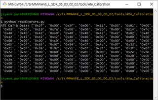

  • Hello.
    According to FAQ post  about ATE, I did below steps.
    1.Flash C:\ti\MMWAVE_L_SDK_05_03_00_02\tools\Ate_Calibration\xwrL64xx\calibration_example.release.appimage
    2. Run readComPort.py script
    3. Flash motion_and_presence_detection_demo.Release.appimage
    4. Debug. Calibration restored successfully. But It suddenly stops at mmwDemoFrameStartISR during hard coding.

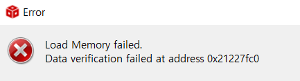

    Yes, I want to run in debugging.
    I followed steps in CCS Debug with IWRL6432 using CCS  12.2ver.
    As I know there is no ccs debug image for IWRL6432. Instead of it, motion_and_presence_detection_demo.Release.appimage were flashed. But it is same, and empty.Debug.appimage too.
    When run Load memory, error occurs.
    JIYEON.
  • Hello.
    Are you resetting the device via CPU reset in CCS Debug before loading your code?  Please do this before loading in your code.  Also usually you can just load the program instead of load memory and just select the generated .out file from the project.
    Sincerely,
    Santosh
    Yes I did CPU reset. "Memory load fail" isn't relevant to "FECSS RF Power ON/OFF failed"?
