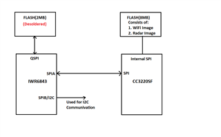

Hello Community,
On the custom board, we have IWR6843 connected with CC3220SF for our application.
We want to use just a single FLASH of CC3220SF for both images and on bootup of the board, I want to transfer the radar image into IWR6843 RAM.
My queries to TI:
1. Is there any example implementation by TI that I could use for this application? This will be helpful and will save a lot of time.
2. If I need to implement protocol by myself, which example should I refer to? How should begin with communication in this case?
3. Which chip will be the SPI Master here? Since communication is initiated by Radar, I think IWR6843 would be the master here.
I have referred to the Bootloader flow swra6 for the SPI Bootmode and mmWave-Radar Interface Control document for SPI protocol.
Please let me know more information on this.
Below is the block diagram of the system we want to implement.
SPIA of IWR6843 MCU is connected with SPI of CC3220SF MCU. SPIB of IWR6843 is pin muxed to be used for I2C communication.
From one of our custom boards, we have removed the FLASH used by Radar MCU that used QSPI for communication.
Now since FLASH is absent ROM Bootloader will begin SPI bootmode using SPIA for communication to get image.
I need a communication protocol example to implement after this, to transfer the Radar Image from the FLASH of the WiFi chip to the RAM of IWR6843 MCU.

  • Hello Santosh,
    Thanks for the reply.
    I have SPIA of IWR6843 connected with WiFi Chip CC3220sf. WiFi chip is connected with its FLASH via its FLASH SPI interface.
    To communicate with the FLASH of the Wi-Fi chip with the QSPI of IWR6843, I will need to connect the IWR6843 QSPI with the WiFI chip FLASH.  Not sure if that would be possible, because of the following reasons:
    1. WiFI chip Flash might not support IWR6843. Its 8MB Flash and is not in the Tested FLASH list of IWR6843
    2. It might affect communication between the WiFi chip and FLASH.
    Instead, since IWR6843 is connected with a WiFi chip via SPIA, I want to load the Radar image from WiFi FLASH via a WiFi Chip using SPIA into IWR6843 RAM during initialization.
    Hence I need some example code to realize that, or some direction to implement it.

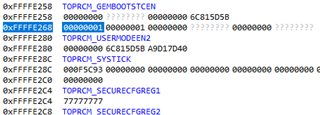

  • Hello Santosh,
    With direct XDS110 I could toggle NRESET of IWR. I tested this with the logic analyzer.
    Also, I switched between Functional and Flashing mode by setting SOPs first and then performing NRESET via XDS110 only.
    Swapnil

  • Hello Santosh,
    Here is the link about XDS110 where supported devices are mentioned, which also supports
    • mmWave sensors (IWR/AWR14xx, IWR/AWR16xx, IWR68xx)
    https://software-dl.ti.com/ccs/esd/documents/xdsdebugprobes/emu_xds110.html
    As I mentioned in my previous reply I could switch between Functional and Flashing mode, I could verify from register content on SOP mode register address 0xFFFFE268.
    SOP mode register: FFFF E268 (Flash mode should read 0x00000005, Functional Mode should read 0x00000001)
    This is the contents of my SOP mode register which verifies that the device is in Functional mode.
    Can you please verify with IWR6843AOP ball pins for SPIA which I asked you in previous reply.
    Swapnil

    The 6843 devices do support XDS110 but only with the mmWaveICBoost board, as these devices don't have an on-board XDS110, so if you want to use any XDS features you need to have an external XDS device or use the mmWaveICBoost board.  Some of the other devices like the AWR1642Boost and the 1443Boost are EVMs that are designed with an on-board XDS, but the IWR6843AOP does not have this feature.
    This looks correct, but you are probably not resetting the device correctly due to the absence of the mmWaveICBoost.  Can you try using this board and triggering a reset to see if you are then able to see the appropriate signals from the device?

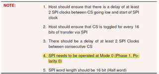

  • Hello Santosh,
    Here is the SPI Initialization for WiFi Chip:
    /* Open SPI as Master */
    SPI_Params_init(&spiParams);
    spiParams.frameFormat = SPI_POL0_PHA1;
    spiParams.bitRate = 10000000;
    spiParams.dataSize = 16;
    spiParams.transferTimeout = 80000; // 1ms
    spiParams.mode = SPI_MASTER;
    and this is what I am trying to send when HIGH_IRQ is there
    SPITxBuffer[0] = 0x5678U;
    SPITxBuffer[1] = 0x8765U;
    SPITxBuffer[2] = 0xFFFFU;
    SPITxBuffer[3] = 0xFFFFU;
    SPITxBuffer[4] = 0xFFFFU;
    SPITxBuffer[5] = 0xFFFFU;
    SPITxBuffer[6] = 0xFFFFU;
    SPITxBuffer[7] = 0xFFFFU;

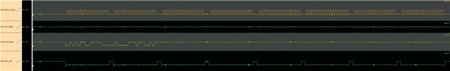

    In the attached diagram you will find the CNYS + Dummy data I sent to IWR when HOST_IRQ was high

    These are the following measures for SPI settings:
    1. The host should ensure that there is a delay of at least 2 SPI clocks between CS going low and the start of the SPI clock.
    2. The host should ensure that CS is toggled for every 16 bits of transfer via SPI
    3. There should be a delay of at least 2 SPI Clocks between consecutive CS
    4. SPI needs to be operated at Mode 0 (Phase 1, Polarity 0)
    5. SPI word length should be 16-bit (Half word)
    Please let me know if it's correct.

  • Hello Santosh,
    By default, CC3220SF has MSB first during SPI transmission. So I think endianness is correct.
    I tried 100Khz just for the experiment and 1MHz yesterday and it is the same behavior, I could try 5MHz, but I think the result will be the same.
    This is the image with the 1MHz clock:
    From this image, you can interpret the data I am sending via SPI.
    Swapnil

  • Hello Santosh.
    As you asked for the HOST_nIRQ line before and after the XDS reset, it remains low for the complete time.
    The measurement is done with 1MHz SPI CLK
    here is the diagram
    The HOST_nIRQ (active low) should go high after sending this command when recognized by the SPI bootloader and then later should send R_AE_DEV_MSSPOWERUPDONE_SB message.

    Page 19
    The highlighted point 4 says SPI needs to be operated in Mode 0(Phase 1, Polarity 0), but Phase 1, Polarity 0 is in SPI Mode 1 not in 0.
    So SPI should be operated in Mode 0 or Mode 1?
    Whichever mode on that device that has phase 1, polarity 0 is the mode that needs to be used for transmitting SPI messages from the host.  If that is SPI mode 1 on the CC3220SF chip, then you will need to use SPI mode 1.  The SPI on the IWR device is set up by the bootloader, so it cannot be changed.

  • Hello Santosh,
    Are those little peaks indicating when you are pressing the reset?
    These are just the noise signals on HOST_nIRQ. The reset comes much before this communication.
    Swapnil
