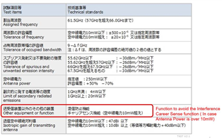

  • Hello Nate
    I got a feedback from our laboratory and it seems that the references you mentioned to in the last topic are only valid for lower frequency systems. The requirements for 57 to 64GHz are defined in volume 2 of the standard and the rules here are different to the snippet you posted:
    It seems that there is a need for a interference prevention function and we have also a limitation when it comes to transmission times (10% duty cycle). But at the moment I've no plan what is really needed to show compliance for such a interference prevention function. Does TI have more information here?
    Ueli
  • Hi Ueli,
    Our field team in Japan has sent us the following link.
    https://www.telec.or.jp/services/tech/criterion/t407_01.html
     They translated this -

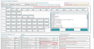

    So it seems that if you keep the transmit power below 10 mW (10 dBm), then you don't need to worry about the carrier sense function.
    The 3.3 msec of ON time does appear to be correct though. You will need to keep your chirp length shorter to accommodate this requirement.
    In the mmWave sensing estimator, you should see a field called "Chirp Compliance Time" that will give you an estimate of how long the chirp duration is to meet this requirement.
    Nate
