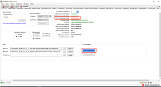

Hi,I've recently tried to capture raw data on mmwave studio 03.01.01.00 using AWR2944+DCA1000, but I'm a bit confused about the data format. I am now able to successfully connect the AWR2944+DCA1000 to my computer and I can see the [Record 2.8] logo. But I am still confused about the format of the collected data.
Doubt 1: Since mmwave studio 03.01.01.00 only supports single real samples, each received ADC data (i.e. LVDS data all the way) is actually data all the way to the RX, is there any problem for me to understand it this way?

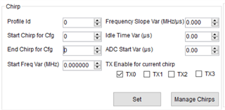

Doubt 2: I know very well how to set the TDM mode of the sender in mmwavestudio 02.01.01.00, and I set it in the same way in mmwave studio 03.01.01.00, but it doesn't seem to work.

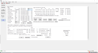

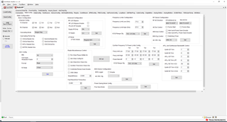

The way I have it set up for sensor config is as follows:
Here's how I set it up in Frame:
That means I'm set up for 3 transmitters and 4 receivers, with 3 transmitter antennas transmitting in TDM.

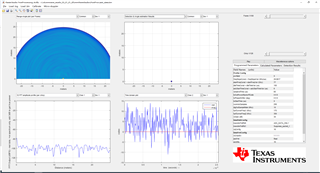

But I end up getting incorrect results after PostProc, I placed a strong reflector (a large iron plate) 1.5m in front of the radar, but the result graph shows nothing, did I set it up wrong somewhere?
AWR2944+DCA1000:
Object to be tested, large iron plate:
The resulting graph after clicking PostProc:
I was shocked at the final result of the Range-Doppler plot being empty, and wondered what had gone wrong, please help with the answer, thank you!

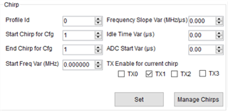

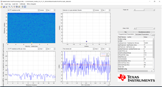

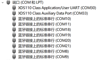

  • Thanks for the reply, my configuration is as follows:
    I set it up for a 1-TX 4-RX mode.The final result of clicking PostProc is as follows:
    As you can see, there are still no results, no human body detected, but the fact that I'm 1m in front of the radar. It looks like it should be caused by the lack of power on the transmitter side and all that is received is the bottom noise. I don't know why this is, please also answer, thank you!
    PS1:I am now able to generate the adc.bin file with a file size of 25600KB = 256*128*4*16bit*100/1024/8bit without any problem.
    PS2:And I have a doubt, how can I distinguish the phase difference when the received data are all real numbers? This will directly affect the angle measurement.

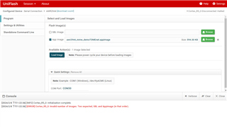

    PS3:I found that it seems like mmwave studio 03_01_01_00 only works with AWR 2944 ES2.0 version, while my own AWR 2944 board is ES1.0 version (because I bought it before March 2023, and I read in other threads that AWR2944 ES2.0 has only been released since March 2023), is there any way to capture rawdata of AWR2944 ES version 1.0 via mmwave studio?

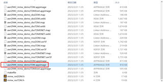

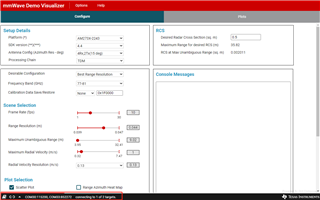

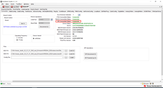

    Thanks a lot for your patience. Please find my responses to your questions as follows:
    1. I am now able to generate the adc.bin file with a file size of 25600KB = 256*128*4*16bit*100/1024/8bit without any problem. -> Would it be possible to share your output log to see all the configurations you have set and the sequence in which you have done so? On first look, are there any configs missed when compared to running TI provided .lua scripts for configuration and capture?
    2. And I have a doubt, how can I distinguish the phase difference when the received data are all real numbers? This will directly affect the angle measurement. -> Once you apply a frequency domain transform using FFT, you should be able to obtain the phase for each component and the samples will be complex.
    3. I found that it seems like mmwave studio 03_01_01_00 only works with AWR 2944 ES2.0 version, while my own AWR 2944 board is ES1.0 version (because I bought it before March 2023, and I read in other threads that AWR2944 ES2.0 has only been released since March 2023), is there any way to capture rawdata of AWR2944 ES version 1.0 via mmwave studio? -> You can use the Studio CLI tool for the capture which should be available on the TI resource explorer.

  • Thank you very much for your reply, and I apologize for being a little slow to respond to some things over the past few days.
    1. this is my output log

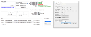

    [00:47:01] [RadarAPI]: ar1.CaptureCardConfig_EthInit("192.168.33.30", "192.168.33.180", "12:34:56:78:90:12", 4096, 4098)
    [00:47:01] [RadarAPI]: ar1.CaptureCardConfig_Mode(1, 2, 1, 2, 3, 30)
    [00:47:01] [RadarAPI]: ar1.CaptureCardConfig_PacketDelay(25)
    [00:47:01] [RadarAPI]: Sending fpga command to DCA1000
    [00:47:11] [RadarAPI]:
    [00:47:11] FPGA Configuration :
    [00:47:11] Timeout Error! System disconnected
    [00:47:11] [RadarAPI]: Sending record command to DCA1000
    [00:47:19] [RadarAPI]: ar1.CaptureCardConfig_EthInit("192.168.33.30", "192.168.33.180", "12:34:56:78:90:12", 4096, 4098)
    [00:47:19] [RadarAPI]: ar1.CaptureCardConfig_Mode(1, 2, 1, 2, 3, 30)
    [00:47:19] [RadarAPI]: ar1.CaptureCardConfig_PacketDelay(25)
    [00:47:19] [RadarAPI]: Sending fpga command to DCA1000
    [00:47:19]
    [00:47:19] ConnectRFDCCard_ConfigMode(): Bind failed (Config port) : 10048
    [00:47:19] Ethernet connection failed. [error -4051]
    [00:47:19] [RadarAPI]: Sending record command to DCA1000
    [00:47:19]

    1. The sequence here seems okay. Would it be possible to change your chirp design with respect to sampling rate, slope etc. and check if it's still behaving similarly? Can you also enable other Tx in your chirp for the sake of test?
    2. Cleared.

  • Hi, thanks for your reply.
    1. I have just changed the configuration as follows:
    I get the following results, still only noise:
    2. the SPI connection in mmwave studio is fine when my DCA1000 works with AWR2944. But when this DCA1000 works with AWR1642, the SPI connection in mmwave studio keeps failing and mmwave studio flashes back. Previously the DCA1000 was successful when working with AWR1642. I recently brought the DCA1000 back home and I am wondering if the bumps in the journey caused the FPGA chip to be soldered falsely, is this possible?
    In addition to this, this DCA1000 is able to appear [Record 2.8] when connected to the AWR1642
    The full Output information is:

    And this AWR1642 can be connected to another DCA1000 properly.
    I want to know that if my DCA1000 connects properly with AWR2944 ES1.0 but not with AWR1642 ES2.0, does it mean that my DCA1000 board is still intact?

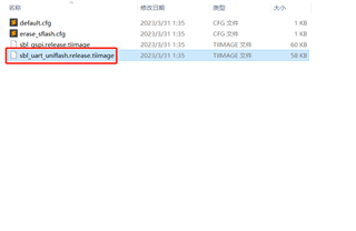

    1. I have successfully burned
    awr2944_mmw_demoTDM.appimage
    sbl_uart_uniflash.release.tiimage
    As shown in the picture below:
    But I am now having problems connecting to the port in mmWave_Demo_Visualizer 4.4.0 as shown below:
    I refer to the post:e2e.ti.com/.../awr2944evm-mmwave-demo-visualizer-unable-to- connect-to-ports. I connected to port 30 using putty and the corresponding putty output is shown below:
    Is there any way to help me to connect to ports?

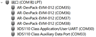

    Hi, please help me to see what is wrong with my operation:
    1. With power off, the SOP is set to 101 and the connections are as shown in the picture:
    The connections are: AWR2944 connects to 12V power supply, FTDI_USB, XSD_USB, and AWR2944 is not connected to DCA1000.
    The device manager is displayed as follows:

    4. Open mmWave_Demo_Visualizer 4.3.0 for port connection, my choice is shown in the picture:
    5. finally mmWave_Demo_Visualizer 4.3.0 has not been connected successfully
