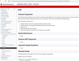

    The Compute Compare Module (CCM) is the R5F sub-system’s implementation for the lockstep error detection logic. The R5F sub-system, when bootstrapped to lockstep mode, has a logic that compares the outputs of the two cores and asserts an interrupt whenever an error is detected. There is also a logic to test the comparison logic.
    The documentation for the CCM is here (where you have installed the SDK in the default location on your hard drive): C:/ti/mcu_plus_sdk_awr294x_08_06_00_19/docs/api_guide_awr294x/SDL_CCM_PAGE.html

  • Dear Shrooq -
    Please see the SDK at C:/ti/mmwave_mcuplus_sdk_04_04_01_02/mcu_plus_sdk_awr294x_09_00_00_15/docs/api_guide_awr294x/SDL_CCM_PAGE.html for usage.
