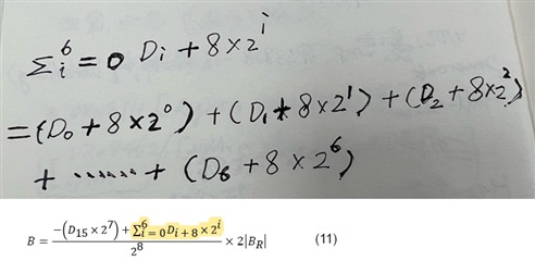

hi,
would you like kindly help check if my understanding of equation 11 is correct?
Thanks for posting your question to the Sensors forum.
I believe there is a typo in equation 11. The correct equation should be:
