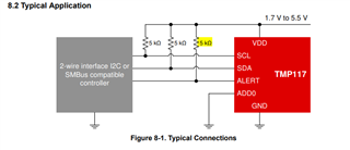

Hi all,
I would like to ask about the pull-up resistance value.
Is it okay to set the pull-up resistance of the ALERT pin to 100 kΩ instead of 5 kΩ?
If Vdd=3.3 V, a current of about 33uA will flow through a 100 kΩ resistor.
Since the Input Leakage current is said to be 0.1uA, I think the current will flow through the resistor without any problem and it can be set to Low.
Let me know if you have any problems.
Ryusuke
  • Hi Ryusuke-san,
    Adding a 100k ohm pullup resistor to the alert line will increase the RC constant of the circuit making it 20 times slower vs. using a 5k ohm. It should work ok, but you need to be mindful of the added delay when it comes to sampling the alert line with an MCU and reading the configuration register--i.e. in certain cases you may clear the alert flag before the line drops low. This will ultimately depend on parasitic capacitance on the traces.
