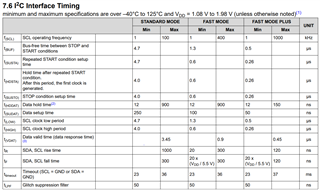

My customer is using the TMP114 and is measuring an SCL fall time of ~6.1ns. They are using a VDD of 1.8V which means minimum SCL fall time is 6.5ns. Is there any concern with going a bit under this minimum and if so, would adding capacitance be the way to go?
