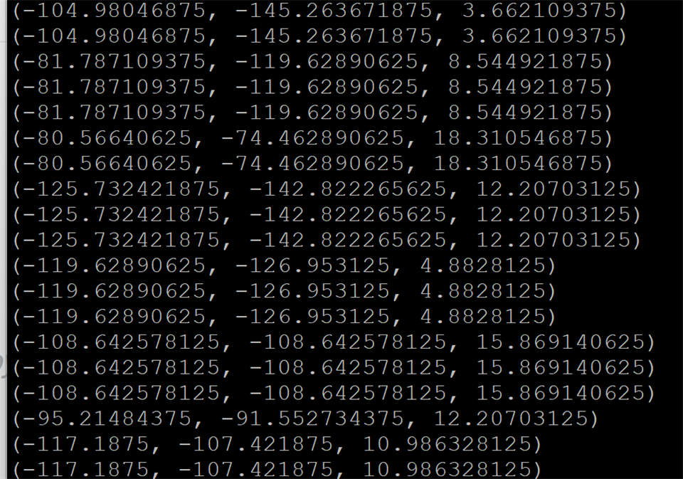

When I am reading the register with I2C it gives following result. I have multiplied the reading with (40000/32768) to get result in uT.
V
I have noticed the value fluctuates around 50-70uT. Is there any particular reason for  this fluctuation? I am aiming to get 2uT deviation when there is no magnet around. Let me know if you need further information.
I am using default setting in all registers.

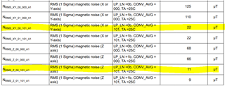

    This device has a RMS magnetic noise of ~22uT when CONV_AVG = 5h for the X-/Y-axis and a RMS magnetic noise of ~11uT when CONV_AVG = 5h for the Z-axis:

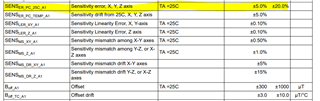

    Additionally, there does exist some sensitivity error:

  • Hi Anil,
    One possible option that may help with the noise is if you do additional external averaging; however, as your targeted accuracy (10uT) falls within the noise range of the device as shared previously, it may still not provide the level of accuracy that you desire.
    Unfortunately, at this moment in time, we do not have any sensors with that level of accuracy.
