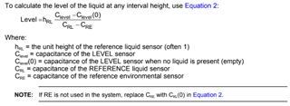

There is an equation that addresses the calculation of level:
The parameter "hRL" in the equation refers to the unit height of the reference liquid sensor, which is typically set to 1. This means that "hRL" represents the height of the reference liquid sensor in the unit of measurement chosen for the system.
After using this equation, the result obtained will have units of length, typically in the same units as the dimensions used in the equation. For example, if the dimensions used in the equation are in meters (m), then the result will also be in meters (m).
If you have any further questions, feel free to ask. Regards.

  • Hello! The measurement reached 15pF before fully filling the container, meaning it saturated beforehand. However, we were still able to solve that saturation issue. The problem we have now is that we don't understand the equation provided in the datasheet for level calculation. Additionally, we also don't understand how to use the CAPDAC compensation in measurements because, in most cases, when the container is empty, the channels start measuring between 4 and 7.5pF.
    Thank you!
    We expect some capacitance to exist when there is no liquid in the tank. The empty container value should be used as the Clevel(0) part of the equation. You mentioned a range for this measurement, is this between different tanks/sensor electrodes or all on the same setup? If it is all the same setup, is there any difference between test setups when the capacitance range shifts? If it is not the same setup, then tolerances between assemblies could be the cause here and you may need to calibrate the zero position on each assembly.
    For using the CAPDAC, it is a digital offset on the capacitance measurement that can be used to shift your measurement reading up to 100pF. After the CAPDAC offset, the capacitance measurement can range from -15 to +15pF. This allows the devices to measure up to 115pF depending on the CAPDAC setting.
