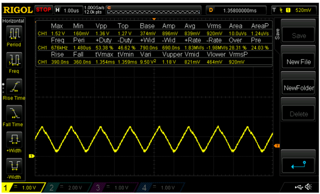

    But in the following picture, I probed the SCL signal, and it's kind of long rise time, right? FYI for the SDA-SCL pullup resistors I used 10kOhm.
    Then I replaced the pullups by using 2.2kOhm, and you could see that the rise time was getting better here, but still found the spikes issue.
    Are you noticing something?

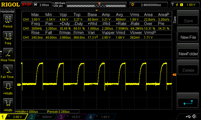

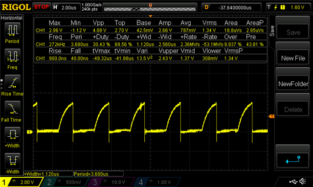

    Just a random question, the FDC2214 VDD is tied to +3V3. How can the voltage amplitude be more than 3V3? Is that normal? *you could see in the signal picture i posted a couple weeks ago.

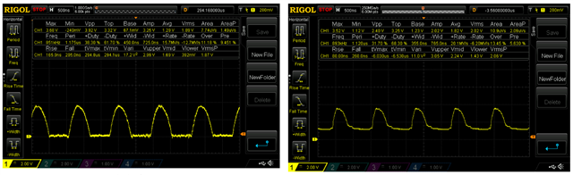

    And I need your suggestion. Currently in my board, we use +-5V for the OpAmp supply. The OpAmp is to generate the guard signal. Regarding use this OpAmp, we have to use +-5V for the supply. I've ever tried to use single supply (+5V and GND) but obtained the output signal like the following picture.
      (left = the input, right = the output)
    In my board, power regulator +-5V have to use several inductors (it's boost converter), and it won't be compatible with my mechanical requirements, which are needing component less than 1mm for the height to avoid crash during motor motion. If I could use single supply for the OpAmp, I don't need to use that OpAmp anymore. Could you suggest me the type of the OpAmp even other suggestions?
    I've ever tried another OpAmp, but obtained an issue, it seems the output signal is like the charge cycle of the C load, like the following picture.

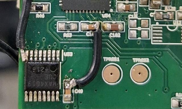

  • Ohya for the switching using multiplexer, after I plugged the long cable, somehow I still found spikes issue on the data reading intermittently while using lower current for the current drive, at 0.867 mA.
    Then I tried to add several ground wires to the multiplexer, like the following picture.
    And it fixed the spikes issue on the setup, using 0.867 mA. But it didn't work for current drive at 0.356mA and lower. Do you think that the spikes issue is caused by weak GND connection as well as previously? Should I add several GND traces in the board design?

    Exceeding 3.3V does seem like it should not be possible. At the FDC INx pins, I would expect a peak voltage of 1.8V.  If it is higher than that, it could be some sort of ground issue.  Are you probing gnd directly at the FDC gnd pin or at some other place on the ground net?
    To the best of my knowledge, all op amps need a positive and negative supply if the signal you are trying buffer is positive and negative.  Maybe an alternative to your switch mode power supply could be a 555 timer circuit for producing the negative rail.  Such a circuit can be found here.
    As additional wires to gnd seem to be helping, it looks as though you have several weak ground connections.   If you consider revising the board design, I would suggest looking at each interconnecting board trace as a nonzero resistor, and the skinnier and longer it is, the higher its resistance.  If you notice a lot of long skinny traces for your board layout, that could be contributing to some of the issues you are seeing.  Ideally you want to have large ground plane with with minimal resistance between different ground pins.
  • Hey Patrick, for the amplitude of excitation signal exceeds 3.3V, I think we might have different measurement concepts on an oscilloscope.
    Depends on the pic above, what is the meaning of Vpeak mentioned on the FDC2214 datasheet? Is Vpeak same with Vmax? or Vtop?
    And if the Vpeak mentioned on the datasheet is Vtop (based on the pic above), and the signal gave a rest wave under 0V (negative voltage), could I use single supply for the voltage and ignore the negative voltage of the wave?
    Btw, does FDC2214 has simulation model? Such TINA model or other simulator...?
  • Hello Specia,
    This diagram illustrates my thoughts on Vpk and Vpp relative to probe connections.  The device needs to see the negative voltage.  If you are unable to provide  a negative voltage, perhaps you can try offsetting the FDC2214 gnd pin to >1.8V. If you have a 5V supply on your board, 2.5V might be worth considering. However you might need some additional circuitry for your communication signals if you go this route.  As of now, we do not have TINA model for this device.

    I was using DC coupling.  Single ended in this case refers to whether you have only a conductive plate at INxA or INxB, whereas differential would have plates at both INxA and INxB. Your FDC LC tank signal should still be straddling FDC gnd.  So if you use a single supply with half of the oscillator signal below gnd, you are going to have issues.
