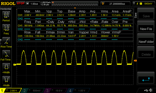

I have a problem with the active shield. I know from the datasheet the active shield signal should be the same with the excitation signal. But after i tried to connect a cable with shield, the active shield signal became a half for the amplitude, but the frequency was still the same. Could you guys elaborate about this issue?
  • This sensor is working by frequency shift, it means we will get change on the reading value by the frequency shift, right??
    But is it okay, if the signal amplitude is different between the active shield and the excitation signal? Will it affect the reading value?
  • Hello Specia,
    Thanks for considering to use Texas Instruments.  Can elaborate on how you connected the cable, is it to a buffered output of the INxA channel? If you are using the active shielding with a buffer, can you provide a schematic with the buffer amplifier and FDC2214? Also where are you probing on the shield, can you provide a picture or diagram?  Are you probing directly with on oscilloscope probe?  It might help to solder a 1k resistor to the shield and then probe the shield signal from the resistor lead not connected to the shield with a high impedance probe.  The capacitance from the probe can influence the measured signal if it is directly connected to the shield.

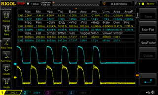

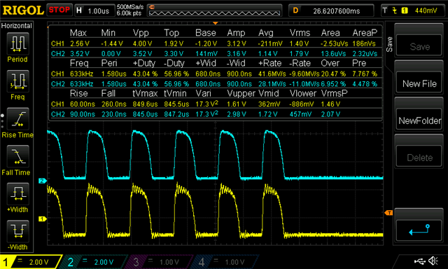

  • That's what we got, even we already put 1k2 between the probe and the shield pad. You could see that blue line (2nd-probe) shows decreased amplitude
  • just notice the blue signal (i didn't probe the yellow one properly), is it okay if the excitation signal appeared like this? I got this since use a current drive at 867uA. As far as i know, the signal should be half-sineWave..
  • related to the waveform,  is it okay if the excitation signal appeared like full-sinewave?

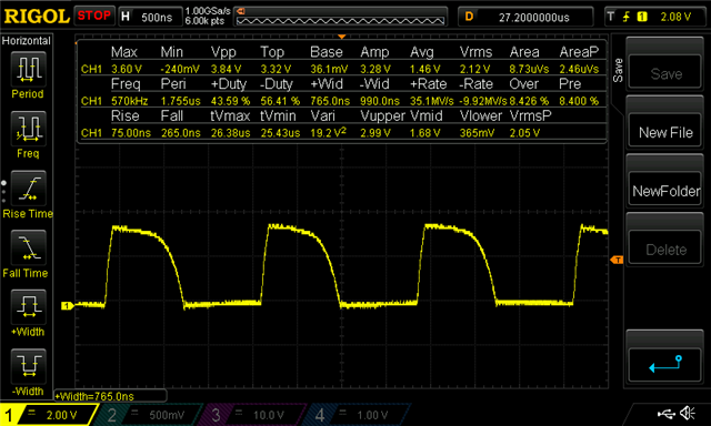

  • Hi Patrick,
    1. Is it okay if the excitation signal appeared like this? Similar to half-sine-wave, but not perfect when I used a current drive at 0.867mA. Is it acceptable by the sensor? The configuration type of my application is single-ended. I got  perfect half-sine-wave like you when the current drive at 0.169mA.
    2. How far is the effect of tuning the current drive? Should i tune the current drive until get perfect half-sine-wave?
  • Hey Specia,
    1- Depending on the channels used and current setting you could drive the excitation signal with up to 1.5mA or possibly higher, with the only stated max being 8mA in abs max table.  So I think from a current standpoint its fine.
    2-While the design could benefit from a cleaner sine-wave, I think adjusting the current drive so that there is some margin above the minimum voltage amplitude specification of 1.2V is more necessary.

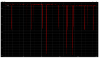

  • Hi Patrick, pardon. I mean about this picture while i am connecting the analog mux. I just used channel 0 only of the sensor.
  •   and this is the sensor reading after I coded the sensor using Python. You could see that only negative spikes existed while I was connecting the analog mux. Are you noticing something from this picture? If the negative spike doesn't exist, i guess the noise will be low.
  • Hello Specia,
    The graph you are showing above looks noisier than what I see from running the device with our EVM.  It looks like the mux you are using is contributing noise to the signal.
  • Hi Patrick, is the negative spike issue related to crosstalk or charge injection of the analog mux? I've tried using an electromechanical relay, but the issue has not appeared yet.
  • Hello Specia,
    It could be either.  Have you tried reaching out to the mux provider?  They might be able to provide better insight into how the mux is loading our device and the LC tank.

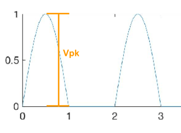

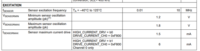

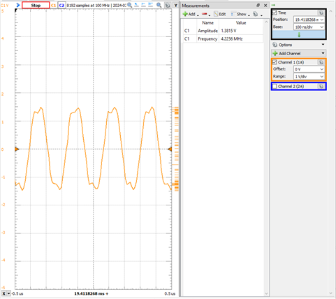

    Btw, i have another question, what do you think if the excitation signal (peak) has amplitude >1.8 V?
    I saw in the datasheet, it said the max amplitude is typically 1.8V.
    You could see i obtained more than 1.8V for the amplitude.
  • what is the meaning of Vpk?
    It should be like that, right? And so it should be between 1.2 - 1.8 V?

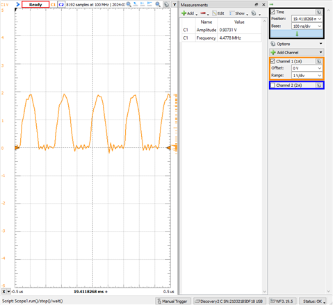

  • And this is the signal when I set the current drive to minimum at 0.016 mA.
    Should I change the LC-tank to fit the oscillation amplitude so it can reach between 1.2-1.8V?
  • I also have other question, how to disable the sensor for a while? Could I use the internal mux to disconnect the INA and INB pins?
  • Yes, Vpk should be as you indicated in your drawing and within 1.2 and 1.8V. Per the datasheet I would try to stay within those bounds.  I will see if I can get some input from our designers as to why. If you switch channels internally, then only the active channel should be influencing the measurements you are reading from the device.

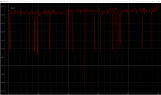

  • Hi Patrick
    This is after I added the filter (C11, C12, C16, C18, choke). You could see that the spike still existed, the sensor showed drifting as well. Any suggestions?
  • Hey Specia,
    Can you clarify that this is a scope capture and not a spectrometer capture?  Also can you comment on where you are probing the signal?

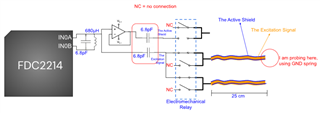

    This is the way i probe the signal.
    You could see I also use two cables with shielding, it is 25 cm length, when i unplugged the cables it's normal, but when i plugged the cables i got spike issue.
    Then i tried to add capacitors filter and choke, like in the eval-module schematic, but yah it's getting worse. Any suggestions?

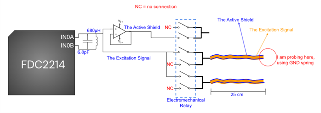

  • I put electromechanical relay, because i have a plan to switch the cable connection for another sensor. I guessed this issue is related to the switching as well. Do you have suggestion a switching without external mux or relay? Such can use the internal mux of the sensor. But even it has internal mux, when it will be connected to an op-amp to generate the active shield signal, it will need external mux as well right?
    The spike looks like weird since it was negative value only, why the spike is not positive value?? Are you noticing something?

  • Hey Specia,
    Thanks for clarifying your setup.  Perhaps you are suffering from contact bounce with the relay.  Im thinking that depending on how cleanly the relay closes, it might distort the signal in such a way that the signal level thresholds are not met during the bounce period, thereby reducing the perceived frequency of the sensor.  As the reference signal is clean and consistent, the fsensor/fref frequency will decrease.  You might see if you can have your rigol setup to catch runt pulses or trigger per pulse width to catch the debounce event.  For fixing the issue, you might try the circuit here. Or you could just keep track of when you switch the relay and delay before reading result and stop reading before switching.

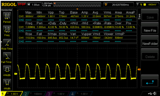

  • btw I've also ever tried a setup like this :
    1. used electromechanical relay, used shorter cables around 3 cm, and didn't get the spike issue anymore
    2. didn't use electromechanical relay, i connected longer cables to the FDC2214 directly around 25 cm, and didn't get the spikes issue as well
    3. used electromechanical relay and longer cables around 25 cm, yah the issue was coming up
    Is this issue related to the long cables? I've also tried to add the filter capacitors like in the eval-module schematic, but yah it didn't fix the issue still got spike issue as shown below for the reading data.
  • Hello Specia,
    I think the issue is related to your relay.  Are you switching the relay at all between measurements?  If so, how long do you wait to collect measurements after the relay switches?
  • Hi Patrick,
    No, I'm not switching the relay at all between measurements, FYI I connected the sensor to normally closed pin of the relay and none of switching
  • I found something here. It's LDC family, but the LC-tank circuit is pretty similar. Can I use the equation 1 and 2 (page 2) for FDC2214?
    Anw still about spikes issue, I've tried to add capacitor in series with the relay (without switching exactly, use the normally close pins), the schematic is shown below.
    and I got signal like here below.
    you could see the amplitude of the signal is lower than amplitude of the signal picture i posted previously. After I add capacitor in series in the relay input pins, the amplitude became 1.6 V w/ 1MHz (while in the signal picture i posted previously, the amplitude is 3.84 V w/ 570kHz).
    and this is the reading data when the amplitude became 1.6V
    And didn't find spikes issue.
    doesn't it show that the spikes issue is coming from out of ideal range (the ideal range = 1.2 - 1.8 V)??

  • Hey specia,
    So my understanding is that you have done a few combinations:
    1. electromechanical relay + short cables : no spikes
    2. long cables : no spikes
    3. electromechanical relay + long cables : spikes
    4. high pass filter caps + electromechanical relay + long cables: no spikes
    Im thinking if it was a matter of post processing error, you should see the spike issue for each test case.  Do you have a spectrum analyzer you can hook up in front of the relay?  Perhaps some external noise is coupling in sporadically.
  • Hi Patrick,
    for number 1 - 3, that's right
    I will correct for number 4. high pass filter caps + electromechanical relay + long cables : SPIKES

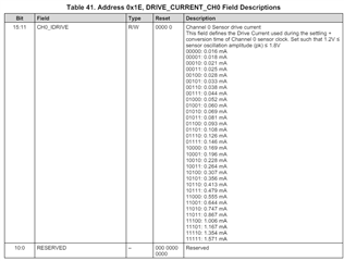

  • I also have another question.
    Datasheet says for current drive setup, it has reserved bits 000 0000 0000.
    I tried to set the current of  channel 0 to 0.146 mA (0x7800). It means the value of register address 0x1E should be 0x7800 (0b0111 1000 0000 0000). Then i set it to 0x7800. But when i tried to read the register, it became 0x7bc0 (0b0111 1011 1100 0000), it means the reserved bits are 011 1100 0000. Is it okay??
    Anyways, what is the meaning of reserved bits in the datasheet? How if the value doesn't match the datasheet?
  • Hello Specia,
    SD and ADDR pin connected to gnd should not be an issue.  I would expect that to only introduce errors if you have a weak ground connection.  Do you use a ground plane on your board?  If so, do you route immediately to that ground plane, or do you have a long thin ground trace going to the ground plane?  Do you have decoupling caps on the supply near the FDC2214 and the STM32F4?
