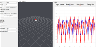

I was being stationary for 1 min and with the radar pointing to my chest...However, the heart rate is always shown as close to 0. I have seen quite many discussions about the vital sign demo in the old industrial toolbox that is not supported any more. But I am not sure if anyone else has ecountered the same in this new vital sign demo.

    Based on the picture shown, it seems the device is not able to track the person. What was the distance between you and the sensor? You can try the same experiment at 2m from the sensor

    On the left side of the panel, the statistics shows there is one target. If you are looking for a 3D red bounding box in the plot, I did make that appear for a few minutes but still got a heart rate around 0. The distance between me and the sensor was 0.5 meter.

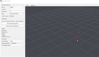

    With respect to the out of box demo in industrial visualizer, actually I've already tried but I don't know what I can get out of it. As you can see from the screenshot below, there are just a few detections in the 3d plot. There is totally blank in "range plot" tab. No range information of the detections at all. I also read the user guide https://dev.ti.com/tirex/explore/node?a=1AslXXD__1.10.00.13&node=A__AHTBr6LTsIaFyYJEZ9kcmQ__radar_toolbox__1AslXXD__LATEST but didn't find anything new there. And the local industrial visualiizer (radar_toolbox_2_00_00_06) is quite buggy. If I send the chirp configuration again, it just stops working, showing either COM error or just stuck there. I need to reboot to get it work again. It is not as smooth as the online visualizer from the visualization & connection perspective. But neither of them can give me the proof of IWR6843-ODS performance so far...

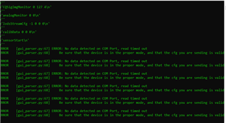

    In addition, there is a LOAD CONFIG FROM PC AND SEND function on the plot tab. I've tried to load profile_2d.cfg from mmwave_sdk_03_06_00_00-LTS\packages\ti\demo\xwr68xx\mmw\profiles but it didn't work. First error compllained about invalid bpmCfg command and thus I just removed the bpmCfg line. Afer that, this error went away but no live plots any more. In the console, it shows an exception (see below). It seems this demo visualizer is not very friendly with IWR6843_ODS...
    Back to industrial visualizer, it is problematic on another angle. I managed sending this modified profile_2d.cfg but there was no range information of the point cloud plot. If I want ot send it again with another profile cfg, it just stopped working by showing below errors. I've tried connection reset or restarting industrial visualizer and none of them works. The only solution appears to be unplug and then plug in the USB port, which is cumbersome. And the error message is not very helpful. If I want to test with my own profile cfg, I would like to have the error message telling me where the error is .e.g invalid bpmCfg or similar.
