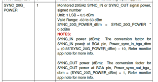

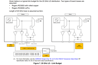

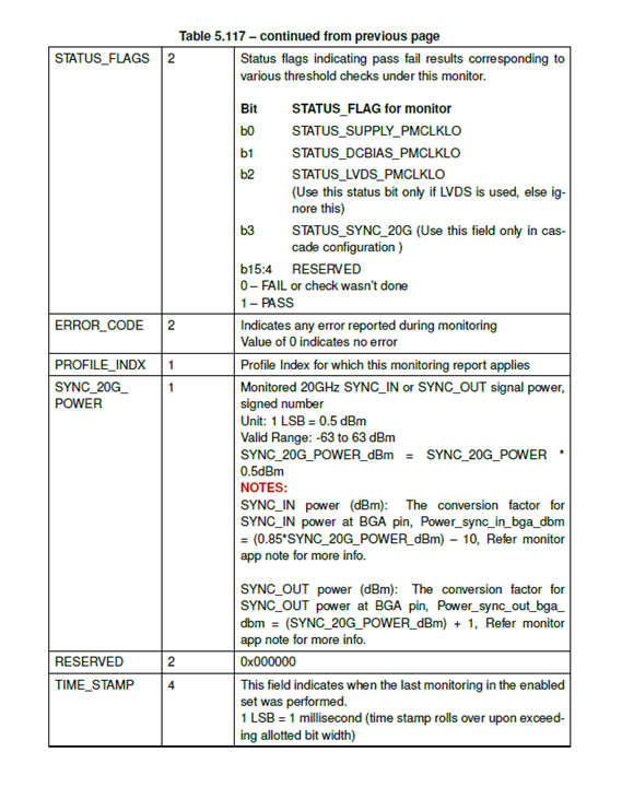

    The PMCLKLO monitor is measuring a value of -3, which if we apply the conversion this comes out to ((-3*0.5)*0.85)-10 = -11.275dBm power at the SYNC_IN ball.
    We can see below that the device requires >= -6dBm at the pin to function properly.
    You mention that this is a custom PCB, what is the stackup you are using? The antenna and 20GHz routing require Rogers laminate to minimize losses on the PCB. With Rogers 3003 you will see 0.15dB/cm of losses for the 20GHz routing. If you are using an FR4 stackup or excessively long routing for the 20GHz LO the losses will be too large.

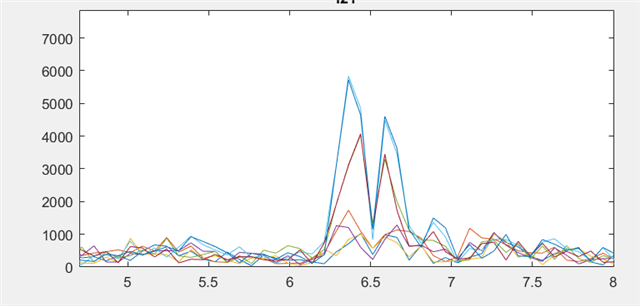

    I now measure 19 on the CLK monitor (-1.9 dBm at the pin) which means that the power level is no longer an issue. However, when collecting data I see a frequency nonlinearity. More precisely instead of having a single peak for a corner reflector I see two peaks as in this figure.
    Do you know from where it could come from?
    Camilla
    What do these peaks correspond to in terms of frequency?
    Does this mean that the sample decay issue is resolved? If so, what was the issue?
    Adrian
  • Hello, the issue is partially solved. The problem was the power at the sync in pin which was too low. But now this nonlinearity showed up.
    In terms of frequency the starting frequency of the chirp is 76 GHz and we are using 2 GHz of bandwidth. The x-axis in the figure is in meters and that is the position of a corner reflector. The issue presents for all peaks, for example similar shapes are obtained from the reflections of the wall.
    Moreover if we use the bandwidth from 77GHz to 81 GHz the time samples present an envelope.
