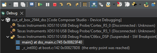

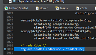

  • Regarding 1&2,  here is what I tried. After running, in debugging mode, I pressed resume to jump to the breakpoint. However, the code jumped to the idle task, I think there is no configuration of any mode (TDM or DDM) has been sent.
    So could please tell me how to send configuration in debugging mode to jump to radarCube to read the raw data ?
    Moreover, I want to know which function is called to read the raw data in out_of_box_2944_dss so I can put a breakpoint at the right place ?

  • Hi Mohamed,
    You can pass the configuration using a software like tera term. Before you set up breakpoints I advise you run the demo as is with the configuration to make sure it is working.
    Can you share what sdk and what demo in that sdk you are trying to run?

  • The sdk mmwave_mcuplus_sdk_04_04_01_02 and the demo "out_of_box_2944_dss & out_of_box_2944_mss"
    1. Are there any steps to send the configuration using the Tera term?
    2. How can we run with configuration and check that the demo worked using the CCS?" The only way I tried and worked was that:
         - Flashing; SBL Image: sbl_qspi.release.tiimage; and App Image: out_of_box_2944.appimage  using UniFlash
         - I used https://dev.ti.com/gallery/view/mmwave/mmWave_Demo_Visualizer/ver/4.4.0/ to send the DDM configuration and display the figures, which means it worked.
    - To debug, I flashed SBL Image: sbl_qspi.debug.tiimage and App Image: out_of_box_2944.appimage, then used CCS.
    So how do I verify the demo is working using CCS? and send configuration in debug mode?
  • 1.Tera term is an alternate way to pass configuration, mmWave Demo Visualizer should be sufficient for your purposes. For tera term you connect the serial port, configure the baud rate, and set up a small transmit delay. You can paste the configuration into the terminal to pass it to the device
    2.To run the demo with CCS, flash the evm with the ccs debug app image given under C:\ti\mmwave_mcuplus_sdk_04_04_01_02\mmwave_mcuplus_sdk_04_04_01_02\ti\utils\ccsdebug. Put the device in functional mode, reconnect to pc, launch target configuration, connect to the core, reset the memory, load the .out file and run. You can use the ti mmWave Demo Visualizer to pass the cfg
