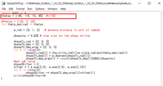

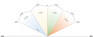

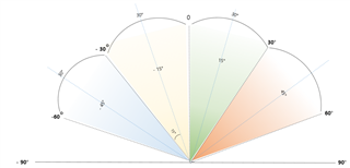

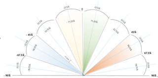

Problem: When the beamforming range is expanded from -/+45 degrees to -/+60 degrees, a problem arises because each beamforming range is 22.5 degrees, resulting in gaps where the beamforming does not reach.
Question: Is there a way to increase the beamforming range to reduce or eliminate these gaps? (long range people detection)
